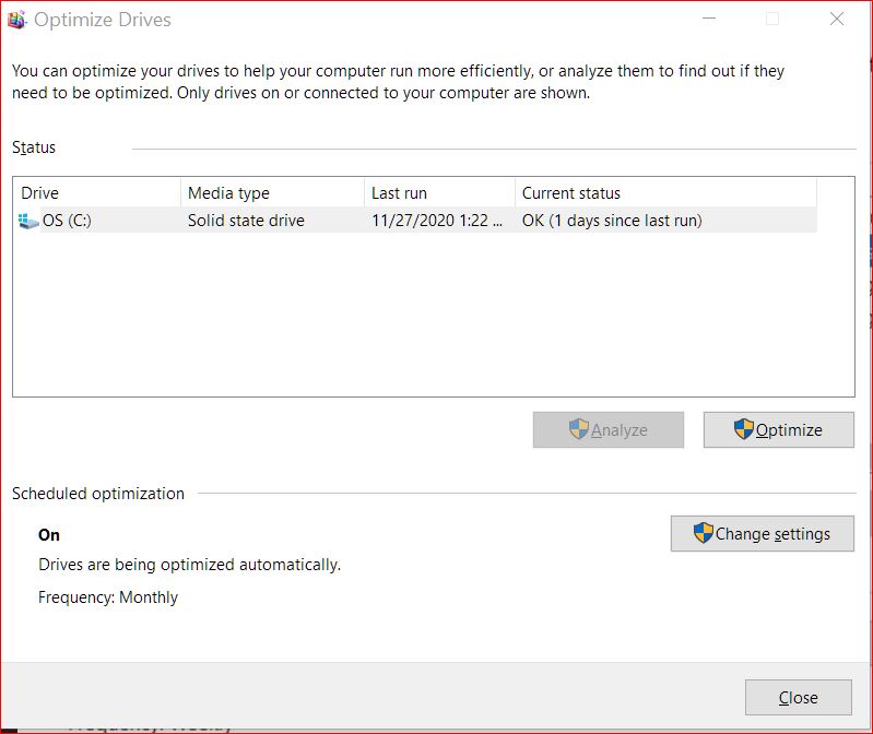

      • #2315478
        My Defragment and Optimize Drive app has a different screen (version 1909). Says neither “Last analyzed” nor “Last optimized” and doesn’t say “Last analyzed or optimized”. It says “Last run”.
        last-run
        • #2315498
          Can’t remember the screen on 1909. I am now on 20H2.
          Mine also stated 13 days since last reTrim (optimized)

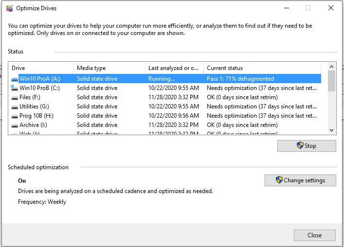

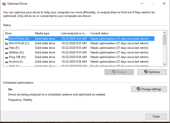

      A picture is worth a thousand words, or so it is said.  I booted into the B side of my desktop which is running 2004.  Here is a snip of the Defrag and Optimize UI taken soon after I signed in.
      Defrag-and-Optimize
      It’s been a while since I was on this side, as you might be able to ascertain.  Next I opened Task Scheduler and manually ran the task (last run had been 11-2-2020).  Then I made another snip while it was doing its thing.
      Optimizing
      What is scheduled is the analyzing part.  After analysis, optimization (retrim) is undertaken if the algorithm determines it to be necessary.  Notice the wording at the bottom of the dialog box; “Drives are being analyzed on a scheduled cadence and optimized as needed.”
      The analysis is scheduled.  The optimization is as needed.  The optimization does follow the analysis, hence it also follows the analysis schedule, but the optimization itself is not scheduled, it is only undertaken as needed.
      • #2315536
        To: @bbearren — As you say:
        Can you post a snip of the what the first screen looks like now, after you optimized.
        Can you also post a snip of what the Task Scheduler>Task Scheduler Library > Microsoft > Windows > Defrag looks like now?
        • #2315579
          Optimize-Drives
          Last-Run

        I have six Samsung SSD’s.  I have Samsung Magician installed, but it defers to Windows to handle optimization, and Windows handles it quite nicely, no issues.
      • #2315822
        SSD’s do slow down on performance when they start getting loaded to max levels
        There is no slowdown until you have so little space left that TRIM can’t clear the data as fast as you write it. I suspect that is around 10GB free, allowing for RAM to disk swapping, but I have not done the tests.
