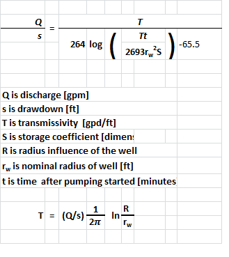

I’m Math Challenged. It’s been too long since I did this type of math.
I need to solve the following equation for T.
Thanks.!!!!

Hi jepalmer,
1. Apply the property of logs, log (X/Y) = log X – log Y.
2. Cross-multiply to eliminate the denominators.
3. Add or subtract terms on each side of the equation so that the terms involving T are on the left side and the terms not involving T are on the right side.
4. Factor out T from the left side.
5. Divide both sides by the non-T term on the left side.
Dave
jepalmer:
I didn’t get it totally solved for T, but …
Also, this reference might help if you can contact the authors as they indicate they programmed this to solve for T.
Maybe they can share the formula with you.
http://www.kgs.ku.edu/Hydro/Publications/1980/OFR80_6/04_geology.html
jepalmer,
Try this formula for calculating transmissivity (T):
Source:
http://info.ngwa.org/gwol/pdf/912955211.PDF
HTH,
Maud
Which is essentially saying, what power do you have to raise 2.71 for it to equal R/rw. You can use the excel Log formula to perform the calculation
