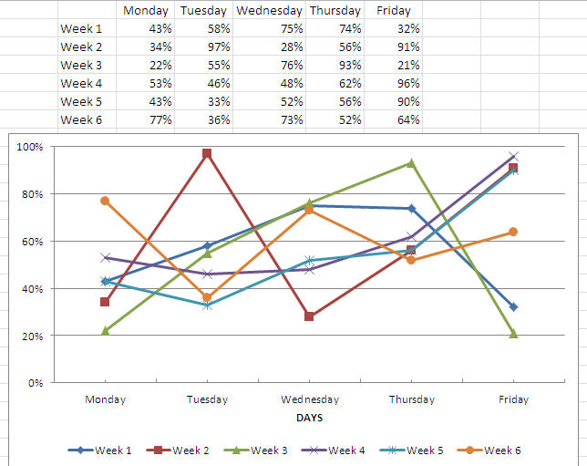

      How is what you’re looking for different from a multi-line graph as created here:
      34602-Clip

    • #1405200
      I think you’re asking for the legend to be on the bottom?
      34603-Clip2

    • #1405224
      In chart data range you enter the range of where the data is located. This is the location of the cells containing your x and y data. If you do this the series will be filled in automatically. If you select the data first (before creating the chart) it will fill in automatically as well.
      If you are going to manually fill in a series, just leave chart data range blank, and click on Edit. The series name is the name/description of the series
      Weeek15
      . The series value is an array of values (the Y values). Either enter a range (you can actually enter equal and then select the range) or enter an array of values in squiggly brackets like:
      ={0.15,0.23,#N/A,0.71,0.93,0.43,0.23}
      You can add a new series
      series name:
      =”Week 16″
      Series value:
      ={0.35,0.42,0.18,0.39,0.64,0.1,0.06}
      You would then enter the Horizontal category x axis and enter the array:
      ={“Monday”,”Tuesday”,”Wednesday”,”Thursday”,”Friday”,”Saturday”,”Sunday”}
      I do not recommend the manual method. I would enter the values Monday through Sunday in the cells A2 through A8, then enter “Week 15” in B1 and enter the respective values (0.15, 0.23 ,=na(), 0.71, 0.93, 0.43, and 0.23 into the cells B2 through B8 and enter “Week 16” into C1 and in C2 through C8 enter: 0.35,0.42,0.18,0.39,0.64,0.1, and 0.06 respectively. The format B2:C8 as percentage. Then select A1:C8, press the insert chart, select the first line chart and the chart will be created automatically.
      Steve
