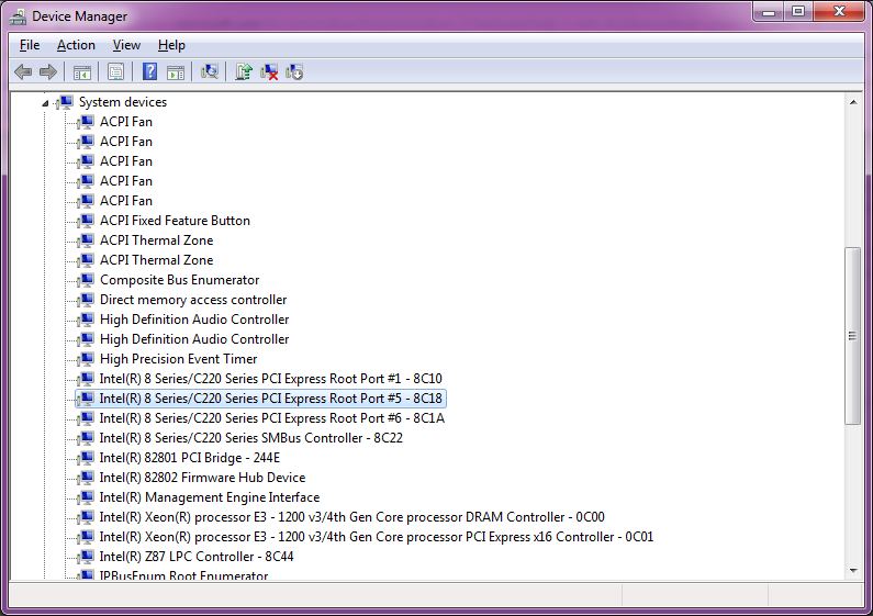

      I just checked Windows Update and there are 2 optional updates showing. They are both Intel system updates as follows:
      Intel – system – 10/3/2016 12:00:00AM – 10.1.1.38 Intel driver update released in October 2016 published 01/01/2017
      I know this post is a few months old, but I’ve been having a problem with my computer (64bit Win7) for a few months and I highly suspect this “update” (v10.1.1.38) to be the cause.
      About a month ago, I suddenly can no longer Shutdown/Reboot from Windows (I must use the buttons on my PC to complete the task.) Note, problem does not occur in Safe Mode or Linux.
      I’ve found that if I disable the driver for my video card (GTX670 in a PCIe slot) or ONE particular driver related to my TV tuner (ATI HDTV Wonder in a PCI slot), everything works fine again. But neither (obviously) is not an acceptable solution.
      With some more experimenting, I discovered that if I rollback one or both of these Intel Device drivers, I can Shutdown/Reboot ONCE. And upon returning, if I put BACK those drivers, I can Shutdown/Reboot ONCE more. Extremely odd.
      Checking my “Windows Update” History, these were the last two hardware related updates installed back in January. As noted by others, no KB number and no information on what changes they may have made or how to undo them (as I mentioned, rolling back the driver only helps one time.)
      Finding this post is the first evidence I’ve seen that this update may be connected to my problem. Does anyone know what changes this update makes and how to undo them?
      TIA.

        Thanks, but I tried a rollback and it didn’t solve my issue.
        It looks like I’m going to have to rely on my last resort: restoring a backup from last July. It works, but has a few issues… most notably something causing a 90 second black screen before the login screen appears. No idea why and not sure how to fix, but at least once I’m in Windows, everything works properly. (I’ll also have to reinstall some software and update my menus/desktop.)
        Thx.

        It gives me an error when I try to run it (even with AV and all background tasks & startup apps disabled.) So I instead restored the original drivers by hand and it didn’t resolve the issue (other than the “one boot” oddity.)

        I’m having my doubts this is exclusively a “driver” issue now since rolling back the drivers only “fix” the issue for a single boot (and no, the driver is not updating on reboot.)
        My suspicion now is that a sloppy “Windows Update” is at fault. MS likes to install WU patches on computers that don’t need them (intended for people who plan to upgrade to 10, etc.) Problem is, there’s no “undo”.
        I’m reluctant to go back to my July backup for another reason I forgot about: my Internet connection was upgraded since then and didn’t work when I tried it. I don’t know if getting it to work again would be a problem (and I’ve had enough of them for now.)

        Do you have a restore point older than the problem? You could try updating or rolling back the video card (GTX670) or TV tuner (ATI HDTV Wonder) drivers.
        Hey Mark.
        Unfortunately, this problem reared it’s ugly head in January and it was February before I realized it was serious. Those Restore Points are long gone (my tiny 120gb SSD only keeps at most one or two.)
        Rolling back the nVidia drivers was no help (and there are no older/newer drivers for the tuner. I’m fortunate the 64bit Vista drivers I found years ago even work with Win7.)
        I tried once more to run the Intel Driver Installer Utility, got the same error as before and noticed it was saying the “Windows Installer Service” was “not running”. So I manually activated it from the CLI and got a tiny bit further only to get a different error telling me the “Base Filtering Engine” service was disabled.
        Long story short, I made things worse trying to restart the “Base Filtering Engine” service. All attempts to restart it reported “Access Denied”. Trying to change the Permissions also reported “Access Denied”.
        I finally gave up, took snapshots of my desktop, all my menus and my Program Files” folders, and just restored my 8 month old backup then spent the new few hours getting it to work smoothly (worked great 8 months ago but things change.)
        After about 30 minutes, I was able to get the Internet connection working again, and while it still has a few small problems (like that annoying 81 second pause before the Login Menu I mentioned above and my TV EPG won’t update), I basically have a working computer once again.
        Some things will just have to remain a mystery. :unsure:
