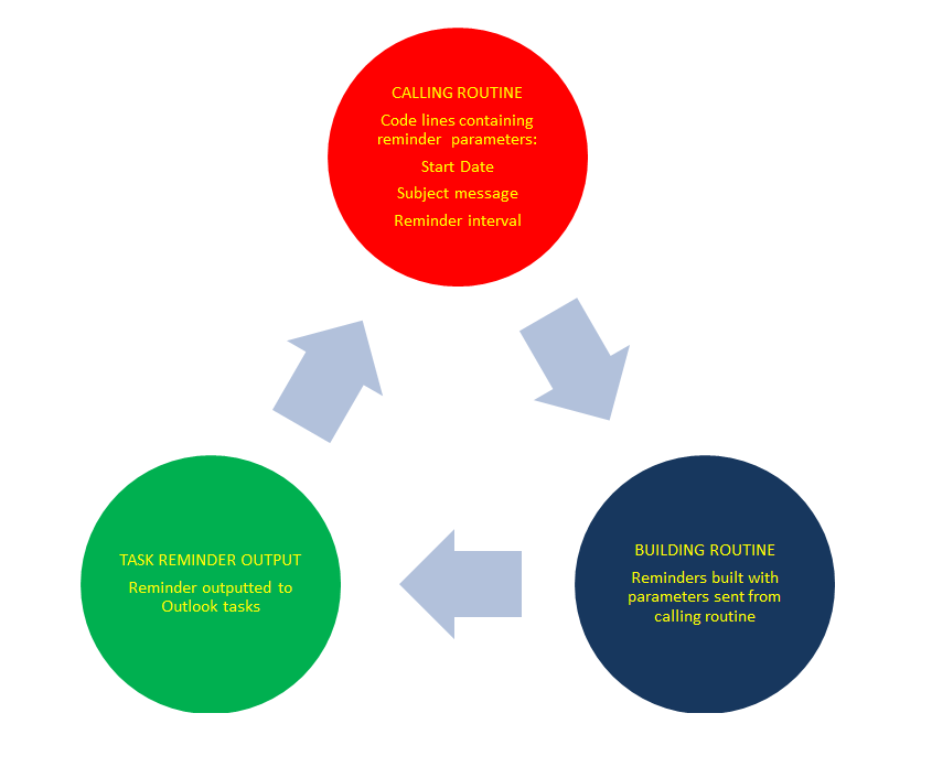

      Here is what I have done so far. It will create reminders for all except Reminder number 3 which you need to clarify
      36571-Tasks1
      36608-PM3
      To run the macro you must:
      1. Outlook must be running but does not have to be the active window
      2. select any cell on the line of the project you want to create reminders for
      3. Click the “Create Reminders” button
      4. Check Outlook for the reminders
      Let me know if we are on the right track

      PM,
      Thanks for that vital piece of info. I have completed the last task (total 6) and all should work now. The code has been modified from the original author’s code from a function to a subroutine and then altered to meet your needs. The specific tasks are originated from a calling routine and are then processed and outputted one at a time to Outlook. If you have to create new reminders, I have an idea for a “Reminder Builder Form”. Let me know how this revised code works out.
      Maud

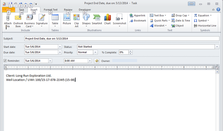

    • #1445873
      PM,
      I have added a couple lines of code that will add the Client and Well Location / UWI to each task which will display in the body of the reminder. I am sure that the task can be directly added to the calendar but I will have to research that a bit.
      36607-PM2
      In the meantime checkout the attached spreadsheet for the updates.

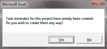

      I have been testing and tweaking the code slightly and everything works fantastic! One question though, as I was testing I found that if these dates are in the calendar and I click the button again it duplicates the event; is there any line of code to put in so that this does not happen? i.e. so it does not put 2x the events in the calendar and maybe a pop-up generates indicating duplicate project?
      Thanks!

    • #1447072
      Greg,
      Due to technical difficulties, I was unable to remote into my work computer where Outlook is installed. However, I have compiled some additional untested code that should work to test if the appointments and/or tasks (reminders) have been created.
      There are two ways to approach this:
      1. The hard way: I have located some code that will actually test to see if there are the tasks/appointments already present in Outlook using the parameters in your workbook. It would need much modification to suit your workbook and since I do not have access to Outlook at present, I have focused on approach 2.
      2. The easy way: A history of tasks/appointments can be created by placing the number 1 in a remote column on the spreadsheet for each project IF the code for that project has successfully added a task or appointment. Each time the code is run, it will for check that column (Column 52) for the history status for that project. If a blank is found (no history) then the code will run and produce the tasks/appointments and then update the history by placing a 1 in the column. If a 1 is found (column 52) then there is a history of the tasks/appointments being made. You will be presented with a message box indicating such whereby you can make a choice to:
      a. Continue to create the task or appointment in which the code will run (Yes)
      b. Decline to continue and the code will be halted (No)
      To remove the history for that project, just delete the value in column 52.
      I hope this addresses your question,
      Maud
      36663-project-overview2
      Inserted are the following lines (blue):
      Tasks (reminders):
      Code:
      Public Sub CreateTasks()
      num = Selection.row
      [COLOR=”#008000″]’TEST HISTORY STATUS OF TASKS[/COLOR]
      [COLOR=”#0000FF”]If Cells(num, 52) = 1 Then
          Msg = “Task reminders for this project have aready been created.” & Chr(13) & _
          “Do you wish to create them any way?”
          Style = vbYesNo
          Response = MsgBox(Msg, Style)
          If Response = vbNo Then Exit Sub
      End If[/COLOR]
      AddToTasks Cells(num, 9), “Project End Date”, 7
      AddToTasks Cells(num, 8), “1st Files to Send”, -2
      If IsDate(Cells(num, 28)) Then AddToTasks Cells(num, 9), “Arrange Monitors”, 7
      If IsDate(Cells(num, 29)) Then AddToTasks Cells(num, 8), “Confirm Monitors”, -2
      If IsDate(Cells(num, 29)) Then AddToTasks Cells(num, 9), “DDS”, 3
      If Cells(num, 20) > 0 Then AddToTasks Cells(num, 21), “3rd Party letters to Send”, -7
      [COLOR=”#0000FF”]Cells(num, 52) = 1[/COLOR]
      End Sub
