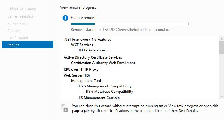

AskWoody LoungerJuly 25, 2018 at 3:50 pm #205844After that last removal and install I am getting a hard error for .NET

jstillings1
AskWoody LoungerJuly 25, 2018 at 4:21 pm #2058564.6 and 4.7 are okay with Essentials 2016, but not 4.7.1 or 4.7.2. https://www.mcbsys.com/blog/2018/06/essentials-2016-dashboard-fails-with-net-4-7-1/ Not sure this related to your issue though. Mark
It shows 4.6 is installed and I do not have the KB for 4.7X installed.
