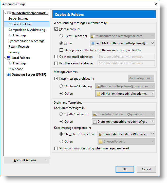

      The Leave messages on the server option only applies to incoming messages.
      To enable server-side storage for sent messages, open Tools > Account Settings > Copies & Folders.
      Under the When sending messages, automatically: item at the top, set the Place a copy in: to Other: and point it to Sent Mail on your email address like this.
      Note: it’s not possible to have it save sent copies both locally and server-side, it’s one or the other.

      I had hoped to save sent emails on the server as well as locally in Thunderbird as Windows Mail did. But now I know that that there was not a problem with the installation of Thunderbird. I will save my sent emails locally in Thunderbird.
      Thank you for this very helpful clarification.
