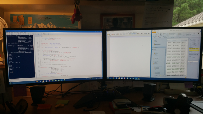

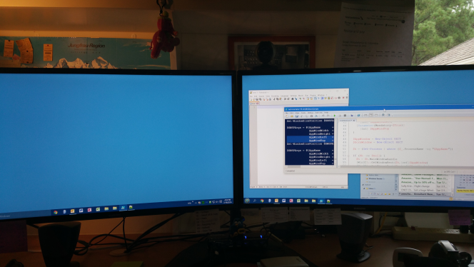

      With three apps open on screen #2:
      45026-Before
      After running the code:
      45027-after
      Program Zip File: 45028-Set-WorkEnv-V1

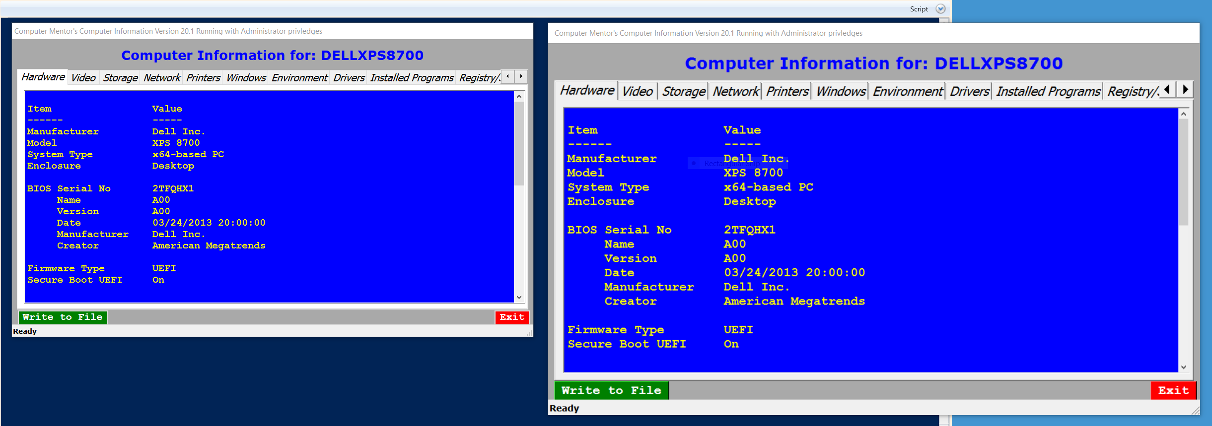

      The moral of this story is be very careful with your development and testing if you are doing GUI stuff in PowerShell as you will get different results between the ISE and CMD versions of PS. I actually noticed this before with my CMsPCInfo program but I thought it was just my eyes but I guess I was actually seeing straight after all! 😆
      The one on the Left run from the PS ISE the one on the right run from the PS CMD! Remember it’s the exact same code!:
      45184-ISEvsCMD
