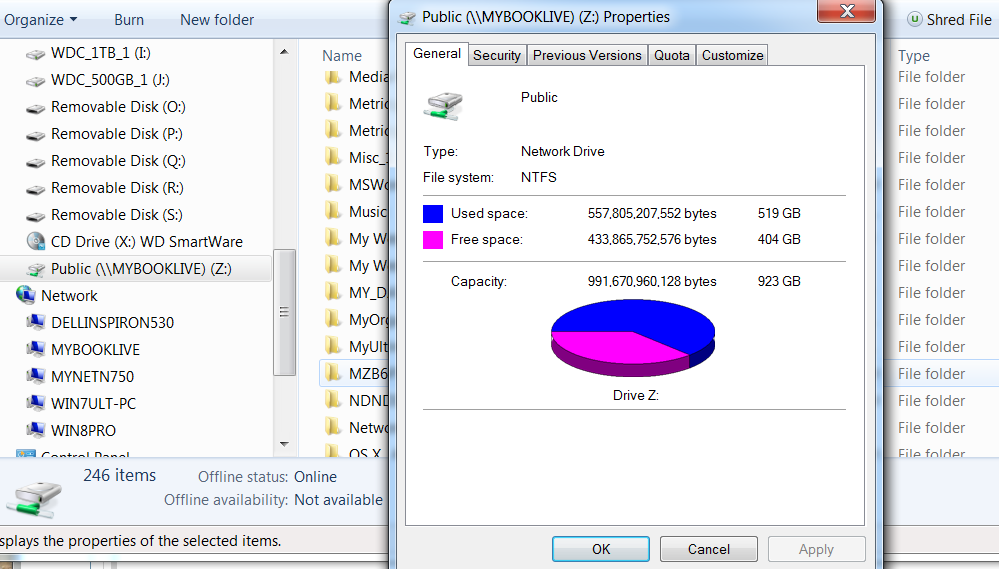

AskWoody_MVPMay 8, 2015 at 2:45 pm #1503682My question: does the NAS allow that type connection? I have a WDC NAS connected to my Router by a straight-through CAT5 ethernet cable. I just checked and the Tools function in the Properties of the drive does not appear on the menu bar while it does appear in Properties of a USB-connected HDD. Based on that the answer to your question is No.
Being there is a type of computer in the NAS it could be connecting directly to a computer will require a cross-over cable, just as if connecting 2 computers together without a Router or Switch between them.

To do this you need to know either the network name or IP of the NAS. In Berton’s post (#7) you can see that his NAS is called “MYBOOKLIVE”.
Enter that name in your browser address bar.cheers, Paul
