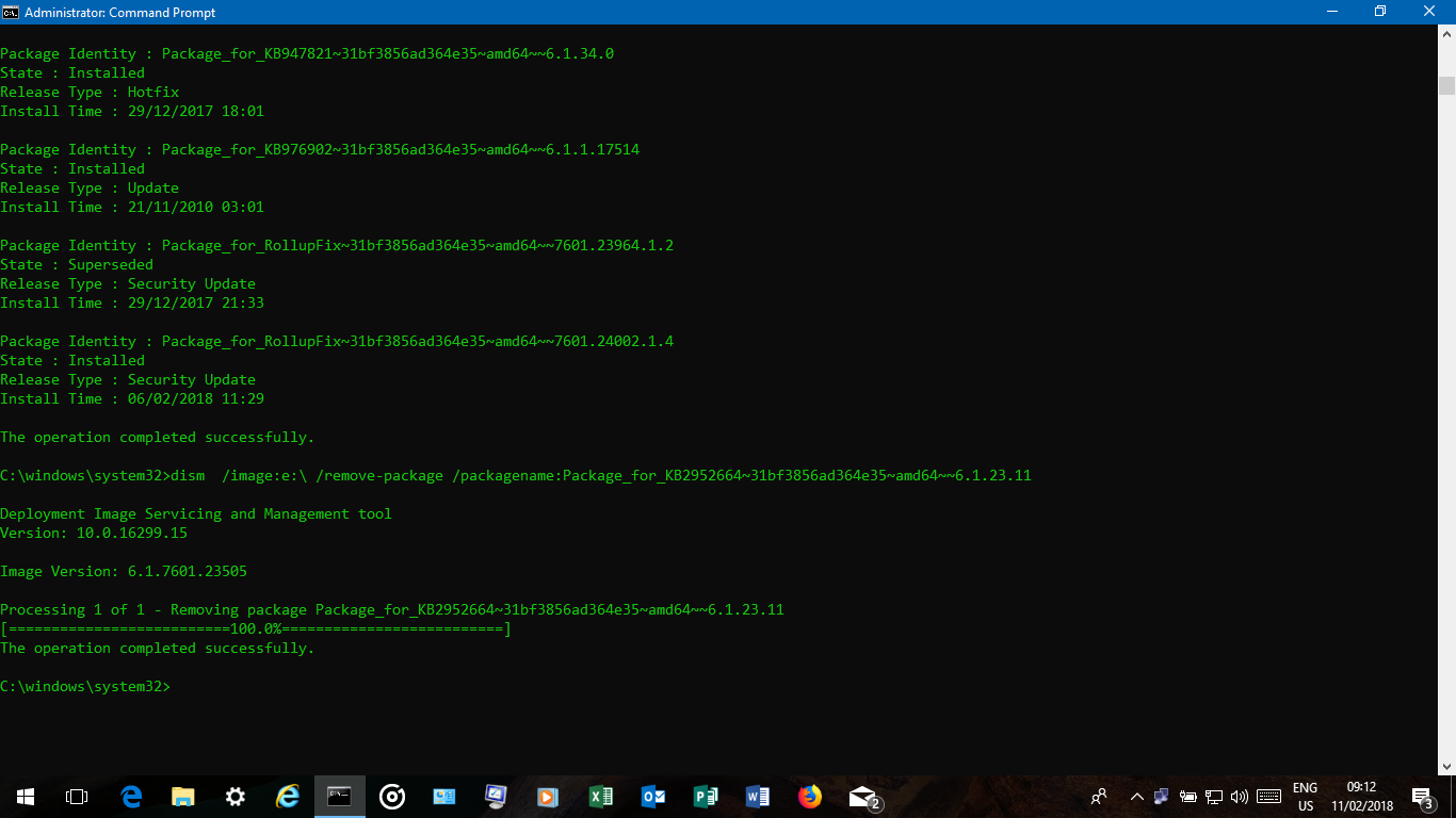

    • #169015
      from recovery console
      c:
      md mns
      Dism /image:c:\ /remove-package /packagename:Package_for_RollupFix~31bf3856ad364e35~amd64~~16299.248.1.17 /norestart /scratchdir:c:\mns
      reboot
    • #169024
