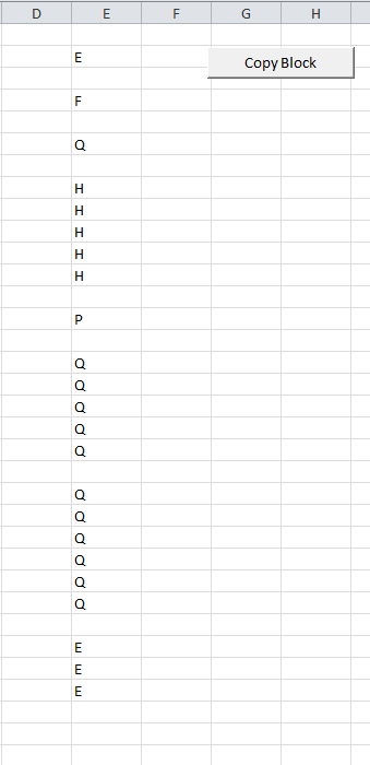

    Can anyone advise me on how I can repeat a copy based on locating the next blank cell in a column.
    I currently use some code based around Ctrl+down and starting in cell “R2C5″ to locate cell before blank, copy that cell contents down to the blank cell find next blank etc.etc.
    Application.Goto Reference:=”R2C5”
    Selection.End(xlDown).Select
    Selection.Copy
    Range(“E7”).Select
    ActiveSheet.Paste
    Application.CutCopyMode = False
    I am not very confident in setting variables and creating loops until done

    • #1422507
      Maud hi
      Not quite what I wanted
      In column E(5) starting at E3, seek next empty cell, move up 1 row, copy, move down 1 row, paste. Repeat until no more

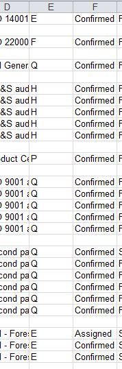

    • #1422634
      Steve
      Not really. We data exported from our CRM as per:
      35464-ExtraProg
      What is required is to copy the last cell with the prog code in “E” down to the next blank cell in “E”. Works fine for all except the last where the code goes to the last cell in column “E” and then tries to paste to the next cell down!
      I have tried all sorts of ways to get the code to check whether it is in the last cell of the column but to no avail.

      • #1422660
        Maud
        Still can’t seem to get the code to work. Attached is a stripped down version of the s/sheet.
        If you run TotalBlocks first and then the ExtraProgCode module the problem manifests itself

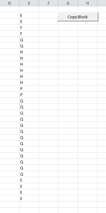

      • #1422893
        Steve
        Thanks for that.
        It works just fine with that line of code added
    • #1422668
      Bonriki
      So now I see where the problem is. You are first running a code that places additional blank cells. A very important piece of information left out. The snippet is called from your TotalBlocks subroutine (last line).
      This fixes it with the extra spaces:
      35477-copy3
      Code:
      Public Sub CopyRow()
      LastRow = ActiveSheet.Cells(Rows.Count, 5).End(xlUp).Row + 1
      [e2].Select
      Repeat:
      AvailableRow = ActiveCell.End(xlDown).Row
      Cells(AvailableRow, 5).Select
      Selection.Copy
      ActiveCell.Offset(1, 0).Select
      ActiveSheet.Paste
      ActiveCell.Offset(2, 0).Select
      If ActiveCell.Row >= LastRow Then Exit Sub
      GoTo Repeat
      End Sub
    • #1422797
      Maud
      Nearly there. Unfortunately there are several blocks that do not get the extra row code applied. This only shows up when the data in the full spreadsheet is treated.
      It seems to be quite random; first block @ line7, 4th block (1 entry)@ line 58, 5th block @ line 63, 12th block (1 entry) @ line 281, 15th block (1 entry) @ Line 298, 18th block (1 entry) @ line 311, 22nd block (1 entry) @ line334, 23rd block (3 entries) @ line339.
      I would like to send you the full file, its not very big, but it is quite confidential
