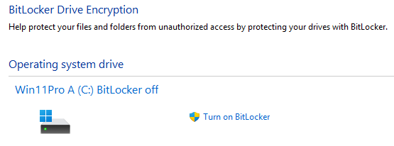

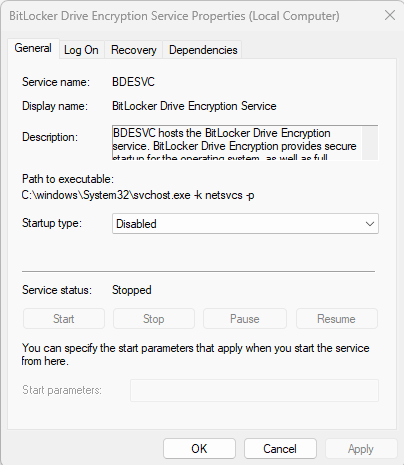

      Disclaimer: I don’t use Bitlocker, don’t ever intend to use Bitlocker, and I disable it in Servicces, along with a few other things. I don’t need a MS account to recover a key.
      In my experience, this method does not trigger Bitlocker encryption. To insure that Bitlocker stays off, as soon as the OOBE is finished, I open Services.msc, scroll down to Bitlocker, right-click and select Properties, then set it to Disabled.
      Bitlocker-Services
      A very simple installation method is to use a fake email address @mail.com for a new MS account. Then when Windows offers to verify the account, decline. Go through the initial setup, add a new account in the Administrators group, reboot and log into the new local Administrator’s account, go through the “Hi” “getting things ready”. Next, delete the fake MS account (there will be warnings), and proceed as you like.
      You can accomplish the same thing using a real MS account for installation purposes, then follow the instructions to delete that user account from your PC.
      I usually create a new Standard user account, reboot, log into the Standard user account and do everything else from there, dealing with UAC as it occurs. This works with or without being connected to the internet.

            • #2759163
              Yea but that’s probably going to trigger bitlocker.  You need to add instructions to disable bitlocker.
            • #2759170
              In my experience, installing Windows 11 Pro, it doesn’t trigger Bitlocker encryption. After the first OOBE is finished, Bitlocker status looks like this:
              Bitlocker-1
              But I’ll edit to add disabling the service.

      • #2759482
        bbearren – When I migrated to Win1022H2 last year disabling Bitlocker in Services “along with a few other things” in Services was near the top of the “to do” list after Win10 install.

    • #2770488
      Re: https://www.askwoody.com/forums/topic/removingbypassnro/#post-2758937
      @bbearren
      in the referenced post, do you disable the Bitlocker  service during OOBE after getting to administrator command prompt using shift F10? Or after OOBE?
      It seems bitlocker starts right after OOBE, so it needs to be turned off during OOBE.  Is this correct? I don’t want bitlocker to start encrypting.
      What other services do you turn off? Any other OOBE tips, or before OOBE tips?
      I will be running the OOBE sometime today or  tomorrow. I have already taken a laptop image before OOBE.
      Thank you in advance,
      Bobolink
      • #2770490
        @bbearren in the referenced post, do you disable the Bitlocker service during OOBE after getting to administrator command prompt using shift F10? Or after OOBE?
        After OOBE (I’ve edited my post to make that clear). In every case where I’ve done this, whether clean install or OTT upgrade, Bitlocker is not running, so it doesn’t have to be stopped. Just Right-click > Properties > Disabled.
        Everything I do is post OOBE. I also disable Windows Backup and Windows Search. Disabling Windows Search doesn’t actually disable Search, just file indexing, which I consider a waste of CPU cycles.
