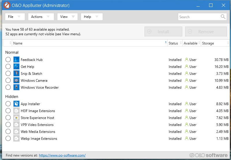

    OOAppBuster

      + Download O&O AppBuster (or portable s/w of your choice) and place it on the Desktop to compare the list of installed Apps with the PowerShell list. This will give you an idea of what to remove and what is left.

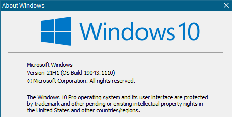

      • #2377857
        another month’s CU and still no ChrEdge or removed crApps!
        winver

      Just tried to eradicate Edge with O&O AppBuster – Failed!
      Tried the Command Line Commands – Failed!
      Tried running both of the above as Trusted Installer via ProcessHacker – Failed!
      So I went OLD School and started the machine in Safe Mode and went about slowly emptying all the Edge directories of files via DEL *.* then went up one level and removed the Directory with RD, wash-rinse-repeat, until they were all gone. Couldn’t remove the Edge directory! Found 2 Hidden Files via Dir /h *.* used the Attrib -h -s *.* followed by Del *.* and they were gone.
      Just to check I ran NirSoft’s SearchMyFiles and found over 150 files still out there. Deleted what I had access to there. I’ll probablly get the remaining 90+ that I got access denied on later.
      I installed the Registry Key to not update as shown above.
      So far things are working as they should – Fingers Crossed. Of course I have a full image of C: taken yesterday so no biggie. I’ll keep y’all informed, especially after patch Tuesday.
