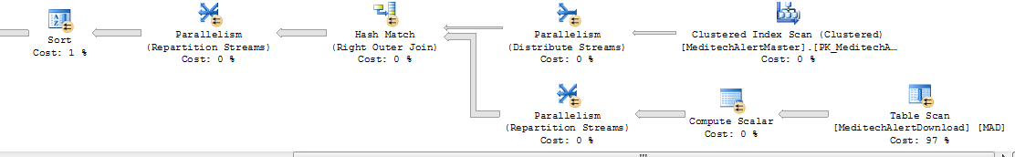

      It’s been a long time since I’ve done much with Access. In SQL Server you can ask the database engine for it’s Query Plan. This is a graphical chart of how the database intends to execute a specific query. All query performance issues tend to go through this tool. Whenever there is a clear A-B comparison (one query form is fast, another query form is slow), the answers can always be found in the query plan.
      44797-Sample-Query-Execution-Plan
