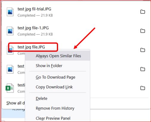

          OK, I’ve finally figured it out!!
          On the 5482, JPEG Image was not listed in the FF Applications list. So, I sent to my e-mail a .jpg file. Then, I went to my e-mail, clicked on the attachment, and downloaded it to the Downloads folder. A dialog box popped up listing the file I had just downloaded. I right-clicked on the file and selected “Always Open Similar Files”.
          Always-open-similar-files

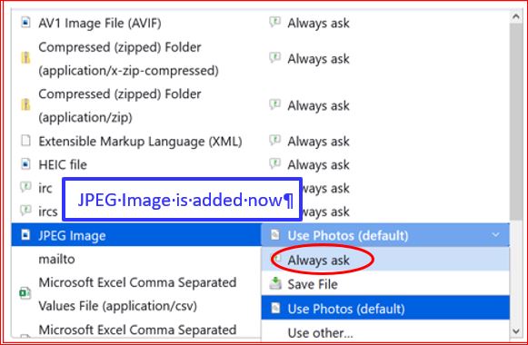

          Then, I went to the 5482 FF Applications list and JPEG Image was now listed. So, that’s how I added it to the Applications list. Then, in the Action column, I right-clicked and changed the Action to ‘Always Ask’.
          Changing-Action-on-JPEG-files
          After changing the Action to ‘Always Ask’, now I get the dialog box that asks me what I want to do with a jpg file.
          What-should-FF-do-with-this-file
