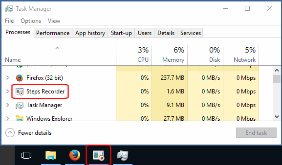

      When you run Steps Recorder, you should see a new icon appear in the Taskbar. If you right-click on the Taskbar and choose Task Manager, you should see Steps Recorder as a running process. Do you not see these?
      44428-psr

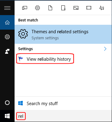

      It’s strange if it doesn’t even appear, because from the screenshot you posted, the psr.exe process is being created.. See if an issue shows up in Reliability Monitor:
      1. Click Start.
      2. Begin typing reliability in the Cortana Search entry box. As you type, View reliability history should appear in the search results.
      44449-reliability
      3. When Reliability Monitor opens, look for any Critical Events and/or Warnings re: Steps Recorder. If there are any, click on the View technical details link in the Action column.
    • #1563467

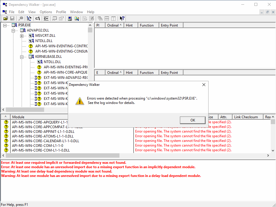

      Your screenshot shows that psr.exe runs but apparently closes without visible or recorded error. If you look at the very last entry it shows something about the process exiting, marked as SUCCESS and with a process status of 2.
      I think that may be a failure to load one (or more) of PSRs dependencies. The only way I know to test this is to use Dependency Walker. I’ve just tested it and Dependency Walker still works in Window 10 x64. (Make sure you download the x64 version and read the FAQ and Help files.)
      1. Download and extract Dependency Walker.
      2. Right-click on depends.exe and choose Run as administrator.
      3. Using File > Open, navigate to C:WindowsSystem32 and load psr.exe. Don’t be surprised by any errors that show in the lower pane, for example:
      44457-psr1
      Click to enlarge
      4. Make sure PSR.EXE is selected in the top-left pane then press F7.
      5. Put ticks in ALL checkboxes then click on OK.
      Report back what you see in the log area (lowermost pane).
