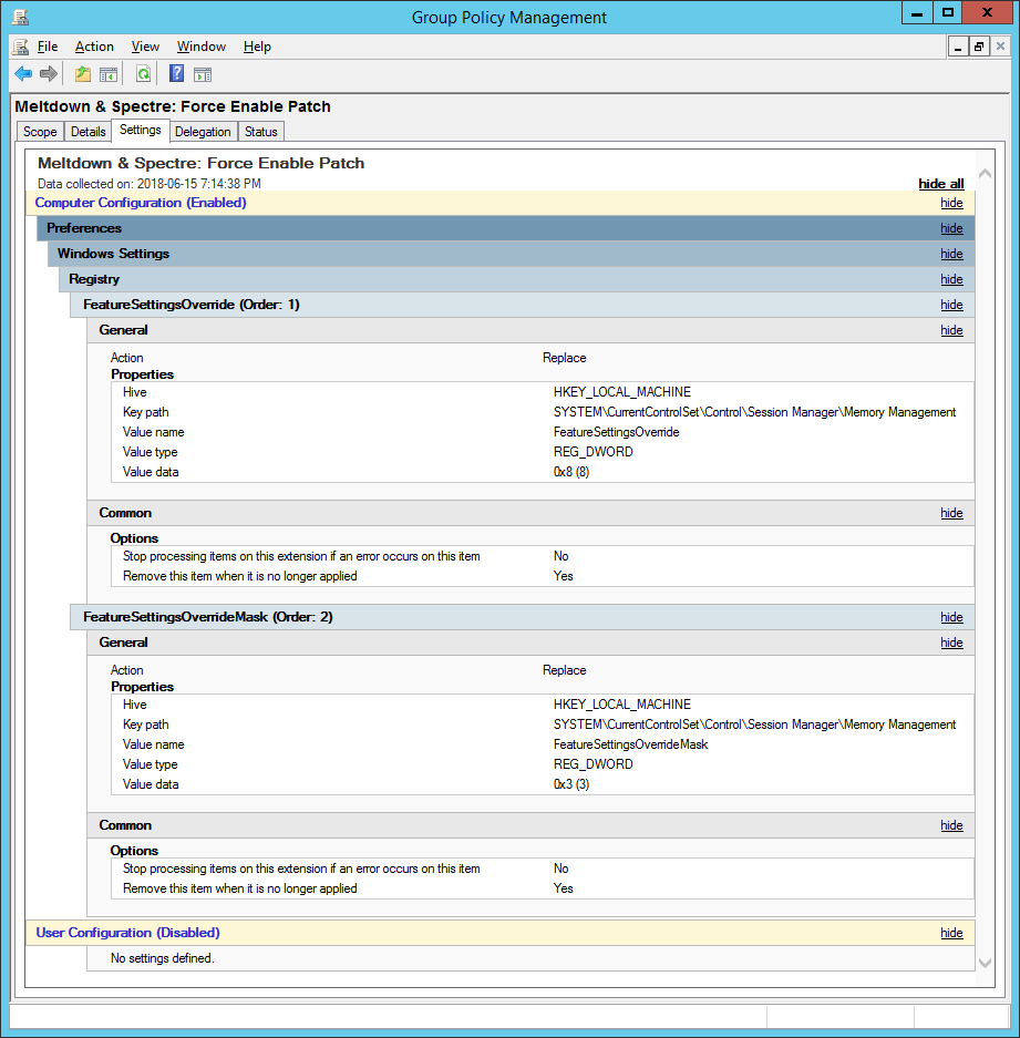

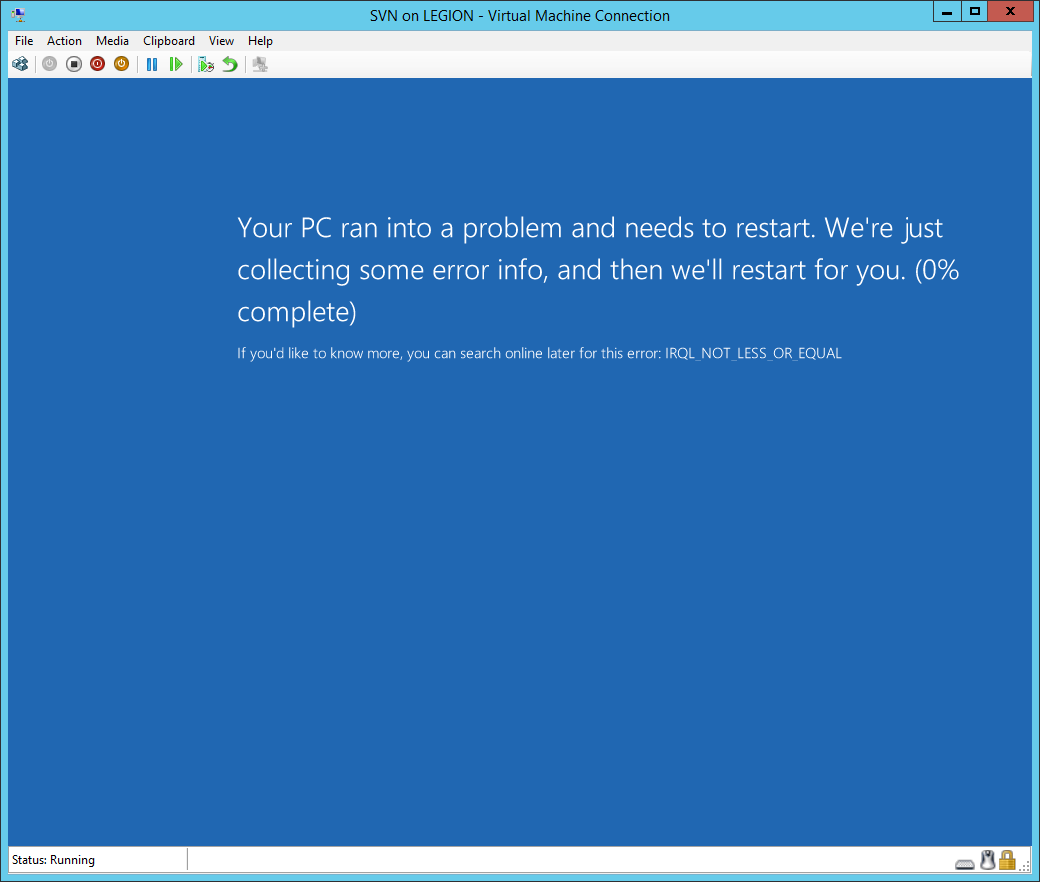

      So in case anyone is wondering, it is a bad idea to enable the Lazy FP State Restore patches inside Server 2012R2 HyperV virtual machines on a host with no microcode update. I am not sure which part of that causes the problem, but it puts you in a bad spot:
      Server-2012R2-BSOD-IRQL_NOT_LESS_OR_EQUAL
      This is the exact group policy I applied, which I believe matches Microsoft’s recommendations to enable the patch for CVE-2018-3639:
      Group-Policy-of-Death
      Essentially, set HKLMSYSTEMCurrentControlSetControlSession ManagerMemory ManagementFeatureSettingsOverride to 8, and FeatureSettingsOverrideMask to 3.
      This resulted in a BSOD on startup for ALL of my virtual machines with this policy applied. Fixing this was annoying, since the VMs wouldn’t boot. You have to use the recovery environment, load the SYSTEM hive, and remove the keys.
      So if you have the same setup as me (no microcode update on the HyperV host), don’t enable the fix! Hopefully this was obvious to everyone and I was just spacing out on a Friday, but just in case, this is fair warning.
