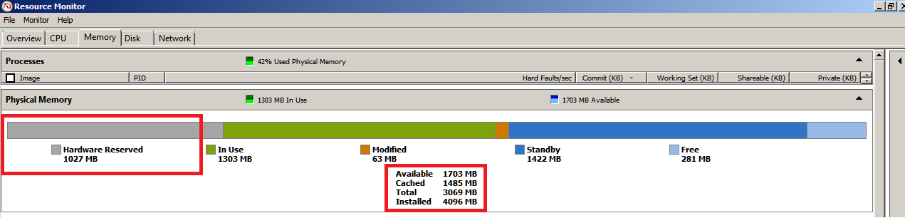

    upon reaching the Windows 7 Desktop, Resource Monitor reports:
    Installed:  4096 MB
    Hardware Reserved:  1027 MB
    Total:  3069 MB
    Windows Task Manager also reports the same “Total:  3069 MB”

          I’ve  highlighted with red rectangles the symptom detected by Resource Monitor in Windows 7 Ultimate 64-bit version:
          Resource.Monitor.Memory.2
          • #2474586
            3,069 + 1,027  =  4,096
            As such, Resource Monitor appears to be correctly accounting for all available physical DRAM (DDR-400:  4 x DIMMs @ 1GB)

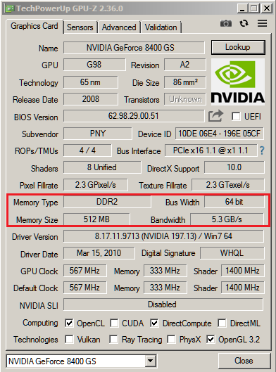

            The sheer amount of “1,027 MB” appears to be mostly unnecessary, in light of the 512MB that is on-board that PCI video card:  PNY GeForce 8400GS

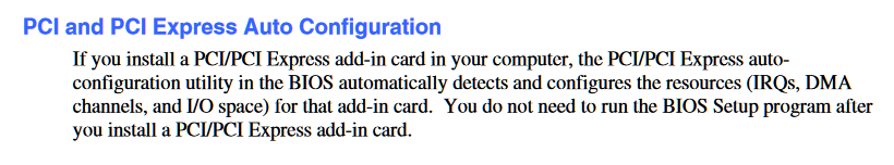

        I tried to find detailed documentation for the BIOS options, but Intel doesn’t build motherboards any longer, and the documentation I do have does not cover those options.
        I found this today:
        http://www.aslab.com/support/kb/133.html
        PCI.and_.PCI-Express.Auto_.Configuration

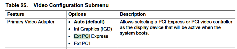

        This website has more information about BIOS video options, for slightly different models of that motherboard:
        https://www.cia.gov/library/abbottabad-compound/69/69410DB208D1F3627C71F6A6C6BA572C_English.pdf
        Apparently, the authors of that manual distinguished integrated graphics and add-on graphics with the nomenclature “Int” and “Ext”, respectively.
        My version of the D915PGN has no port for IGD (Integrated Graphics Device? or Display?)
        I just now inspected the rear I/O panel, and a VGA connector is missing;  the I/O shield is empty there.

            The BIOS appears to be reserving, and doubling, the amount of video RAM that is on-board the PNY PCI GeForce 8400 GS video card.
            In the results of my Internet search, this has been called the PCI “memory hole”.
            So, a good test of that theory is to try a different PCI video card that has much less on-board video RAM e.g. 64MB.
            I already did try a PNY model NVS 280 PCI video card with 64MB of on-board RAM, but there was no video output during POST (BLANK monitor).

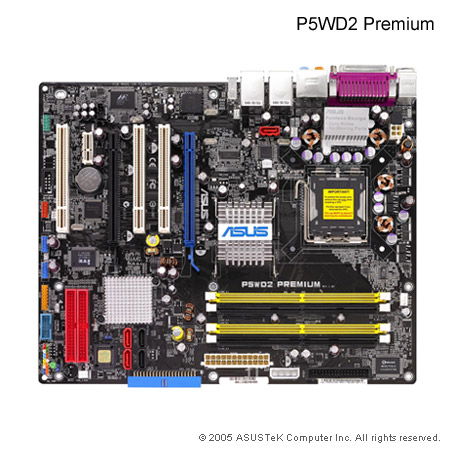

      Here’s a useful comparison to an ASUS P5WD2 Premium motherboard, now populated with 8GB of memory:
      Resource.Monitor.Memory.Paul24.1

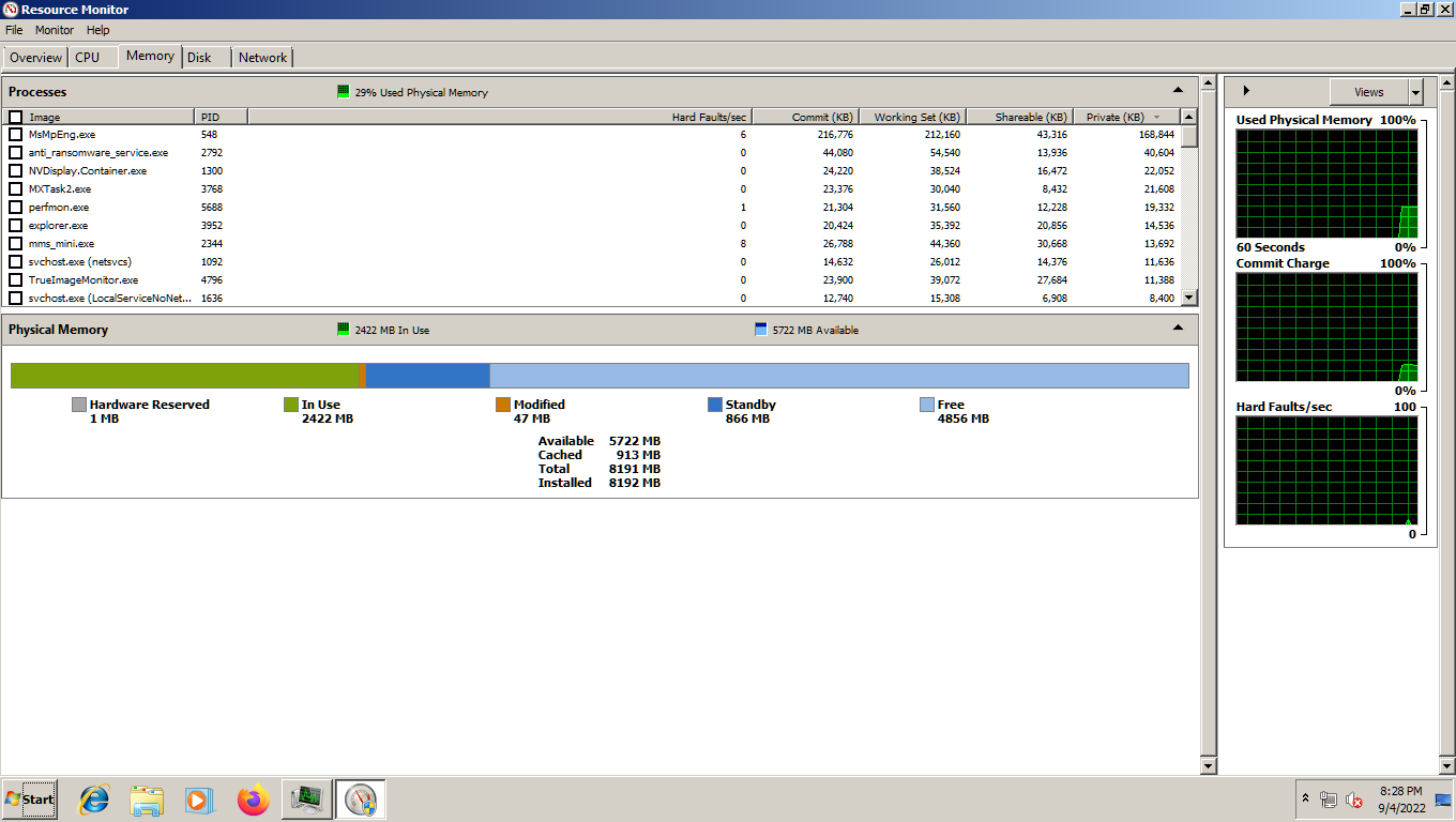

        The Resource Monitor screen shot above confirms what you wrote.
        The User Manual for our ASUS P5WD2 Premium motherboard says this about that chipset:
        Northbridge:  Intel 955X Memory Controller Hub (MCH)
        Southbridge:  Intel ICH7R
        Also, we have XP running on that same motherboard.  Windows Task Manager reports 3,144 MB of “Physical Memory” even though it has 4GB installed.
        THANKS AGAIN!
