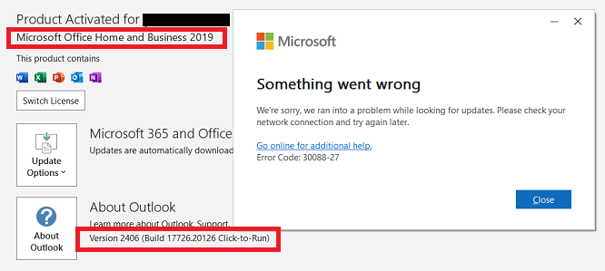

    I was running Office 2019 click-to-run (same version for 365) V2405 17628.20164) from June 19.  It updated today to V2406 17726.20126 from June 26.  With the new 2406 I noticed A failure to check for updates giving
    Something Went Wrong – error code of 30088-27
    I tried an online repair which didn’t fix the issue.  I then completely deleted and reinstalled Office 2019 from my MS account.  After activating I was on V2405 17628.20144 from June 11.
    Everything was working fine, and when I checked for updates it worked, and updated back to V2406 … and the update error 30088-27 came back!  So I did yet another reinstall and I’m staying on 2405 for now … unless it auto updates again and breaks.
    I’ve seen a few posts on the web seeing the same thing using 365 and other click-to run on 2406 … but not many posts.  So I don’t know how widespread the issue is, but something may be breaking the update service in the current Office V 2406.
    Anyone else seeing this?

    • #2684292
      Hi Brocktoon:
      Thanks for posting about this.
      I’m currently using Microsoft Office Home and Business 2019 C2R Version 2406 / Build 17726.20126 (Current Channel, rel. 26-Jun-2024). I normally just let my MS Office 2019 C2R update automatically but after reading your post I tried a manual update at File | Office Account | Update Options | Update Now and got the same error 30088-27.
      MS-Office-2019-v2406-Build-17726_20126-Manual-Update-Check-Error-30-Jun-2024
      Per Susan’s suggestion I’ll just sit tight for now and wait for Microsoft to (hopefully) fix this on their back end.
      Dell Inspiron 15 5584 * 64-bit Win 10 Pro v22H2 build 19045.4529 * Firefox v127.0.2 * Microsoft Defender v4.18.24050.7-1.1.24050.5 * Malwarebytes Premium v5.1.5.116-1.0.1252 * Macrium Reflect Free v8.0.7783 * Microsoft Office Home and Business 2019 C2R Version 2406 / Build 17726.20126

      • #2684305
        Same issue here.
        Microsoft 365 Apps for Business
        Version 2406 (17726.20126 Klick-uns-Los)
        Aktueller Kanal

        how do you patch or fix if the update system isn’t working?
        Hi Brocktoon:
        According to the release history <here> for retail editions of MS Office 2016 / 2019 C2R (Current Channel)  our Version 2406 / Build 17726.20126 (rel. 26-Jun-2024) is the latest release so there’s nothing to worry about for now. At this point the best thing to do is wait to see if Microsoft can fix the problem on their backend servers.
        In a worst case scenario where Microsoft can’t fix the problem from their end and they start releasing new builds with critical security fixes we can easily roll back to an earlier version of MS Office where manual updates were working (e.g., Version 2405 / Build 17628.20164 *** released 19-Jun-2024) as instructed in Diane Poremski’s Uninstall Updates in Office ‘Click to Run’ on their slipstick.com site and then see if the update runs.  There’s no point trying this now because you’ll just update back to the buggy Version 2406 / Build 17726.20126.
        Keep in mind that for now we know that manual updates aren’t working for some of us in Version 2406 / Build 17726.20126, but that doesn’t necessarily mean that a Click-to-Run update won’t be automatically delivered in the background when the next build is posted.
        __________________________
        ***  Note: You would enter the command
        "C:\Program Files\Common Files\microsoft shared\ClickToRun\officec2rclient.exe" /update user updatetoversion=16.0.17628.20164
        in an elevated command prompt to roll back C2R editions of Outlook 2016, 2019, or M365 to Version 2405 / Build 17628.20164.
        Dell Inspiron 15 5584 * 64-bit Win 10 Pro v22H2 build 19045.4529 * Firefox v127.0.2 * Microsoft Defender v4.18.24050.7-1.1.24050.5 * Malwarebytes Premium v5.1.6.117-1.0.1270 * Macrium Reflect Free v8.0.7783 * Microsoft Office Home and Business 2019 C2R Version 2406 / Build 17726.20126

      Thanks for sharing this; it is occurring on my computers a well. On 2 Win 10 machines running MS Office Pro 2021, on which MS Office is updated manually (but often) this morning:
      The computer in which MS Office Pro was was updated recently (within days) yielded the Error Code: 30088-27 upon attempt to manually update MS Office.
      The computer on which MS Office had not been updated for over 2 weeks first received an update successfully then upon another attempt yielded the same Error Code 30088-27.
      I’m not sure how MS will update a broken updater but for now will leave it set to auto update.

      Just adding to all of the above. Until today I hadn’t heard of error code 30088-27.  Last month’s MS 365 update ran normally. Today (following Susan’s OK) I ran my usual schedule, firstly to update MS 365, then Windows.  (I am on Windows 10 Pro 22H2.)
      I got my first 30088-27 as soon as I tried to run the Office update (normally disabled during the month).  Tried Quick Repair, rebooted, to no avail.  As Office was still working OK, I skipped through and did the Windows updates – all OK.
      After rebooting, tried the Office update again – still NG.  Eventually downloaded 365 again on top of my existing version.  This succeeded and downloaded v2407 (17830.20138) which I assume is the latest version.
      Just for fun, I tried the Download Now button again – still got the same error.  That’s when I came here and found this thread.  So I will leave things as they are now until MS fixes the problem and/or a permanent solution is published on this site.

      Again the same drama as on 09.07.2024:
      MS has released another update for Office 2019 on 01. August 2024 (this time version 2407 – Build 17830.20138).
      https://learn.microsoft.com/en-us/officeupdates/update-history-office-2019#retail-versions-of-office-2016-c2r-and-office-2019
      And as at the beginning of July, the issue couldn’t be resolved. Opened the administrative command prompt again and this time entered the following command:
      “C:\Program Files\Common Files\microsoft shared\ClickToRun\OfficeC2RClient.exe” /update user updatetoversion=16.0.17830.20138
      Again the update was installed, but no further updates are possible since. Obviously the problem in question – error code 30088-27 – persists on a higher patch level 🙁
      Disgraceful.

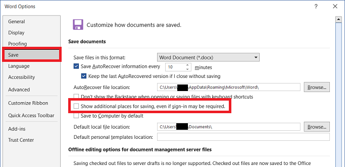

      I have seen that when you disable:
      File –> Options –> Save –>
      “Show additional places for saving, even if sign-in may be required.”
      and sometimes:
      “AutoSave OneDrive and SharePoint Online files by default on Word”
      once, that it then should be fine.

        Hi Brian:
        Thanks for the suggestion, but I launched my MS Word 2019 and DISABLED File | Options | Save | Show Additional Places for Saving, Even If Sign-in May Be Required and rebooted my computer and that did not fix my 30088-27 errors. Note to others: This setting does not exist in my MS Outlook 2019 options.
        Microsoft-Word-2019-v2407-Build-17726_20166-Options-Save-Additional-Places-DISABLED-14-Aug-2024
        I might be looking in the wrong place (or it simply might not exist in my perpetual edition of MS Word 2019), but I could not see a setting named “AutoSave OneDrive and SharePoint Online Files by Default on Word” at File | Options | Save.
        Dell Inspiron 15 5584 * 64-bit Win 10 Pro v22H2 build 19045.4651 * Firefox v129.0.1 * Microsoft Defender v4.18.24070.5-1.1.24070.3 * Malwarebytes Premium v5.1.7.121-1.0.5002 * Macrium Reflect Free v8.0.7783 * Microsoft Office Home and Business 2019 C2R Version 2407 / Build 17830.20166
