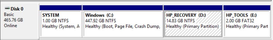

    My Laptop is an HP ProBook 450 G2 and it started out as W7 pro. On 8/4/15, I upgraded to W10 Pro.
    My question is related to the HP Recovery partition on the HDD.
    Since Win 10 has taken over the old win 7 key, is there any reason to keep the recovery partition? In other words, if I had to actually use the Recovery system, would it be valid/work since it is now a Win 10 system?
    My thought is that if the recovery would no longer work, it is just wasting space on the HDD.
    Thanks for any responses.
    44308-HP-Drive-Partitions

    • #1561710
      As you can see from the Disc Manager pic I posted in the OP, HP Recovery D : is located next to Windows C : so I will look at the link you posted.

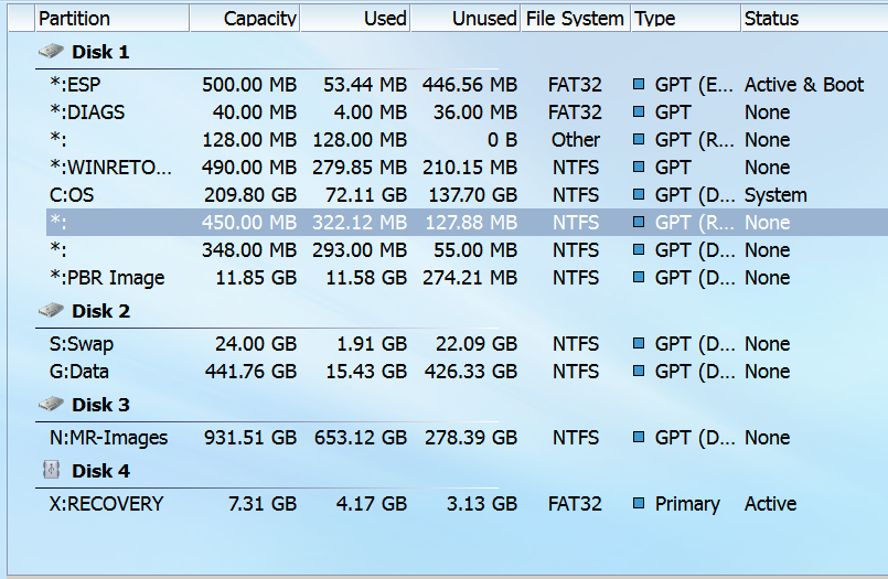

    • #1561798
      Hey Y’all,
      Since this seems to come up frequently I thought I’d publish a step-by-step how-to on the topic.
      The following was done on my main desktop machine (Dell XPS8700) running Windows 10 Pro.
        [*]Make SURE you have a FULL DRIVE IMAGE AND WORKING RECOVERY MEDIA (BOOT IT TO MAKE SURE!) FOR YOUR IMAGING PROGRAM!
        [*]Make SURE (BOOT IT TO MAKE SURE!) you have a WORKING WINDOWS RECOVERY DRIVE (CD/DVD or USB)!
        [*]Make SURE (BOOT IT TO MAKE SURE!) you have a bootable copy of Partition Wizard Mini-Tool just in case!
        [*]Re-Read Steps 1-3!
        [*]Use Partition Wizard Mini-Tool’s Explore function to decide which partitions you want to delete.
        Starting Partition Setup:
        44317-BegPartitions
        Example of Explore feature (get there by right-clicking on the partition you want to explore)
        44318-PWMT-Explore
        NOTE: I’ll be deleting the three (3) partitions following C: on Disk 1.

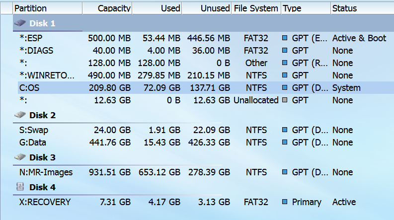

        [*]With the Mini-Tool delete the selected partitions. Don’t forget to Click the APPLY button!
        [*]Reboot to make sure you haven’t bolixed the boot process. Use the Windows Recovery Drive to recover from an error here (Fix Boot). If that fails dig out that Full Drive Image and Restore it.
        Mid-point Partition Setup:
        44319-MidPartitioins

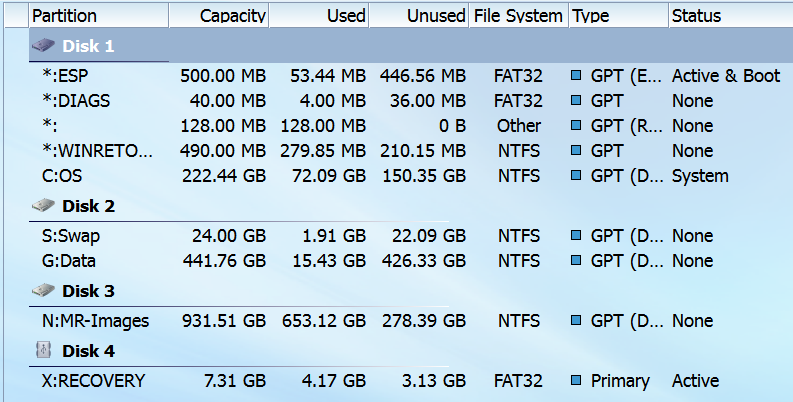

        [*]With the Mini-Tool extend your C: drive to use the free space. Again don’t forget the Apply button.

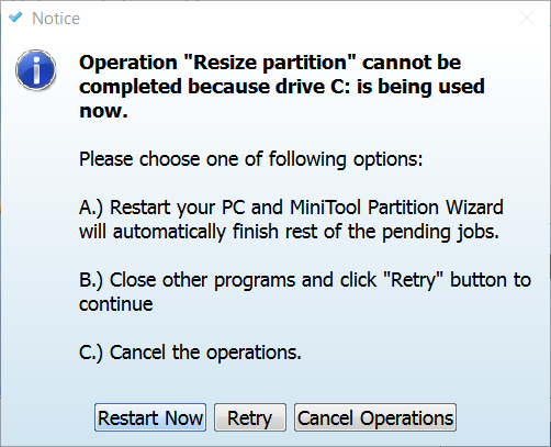

        [*]You’ll get a message box like the following:
        44321-PWMT-Message
        [*]Click the Restart option. You computer will reboot and make the changes at the “DOS” screen then reboot again back into Windows.
        [*]Enjoy your new larger C: drive!
        Final Partition Setup:
        44320-AfterPartitions
