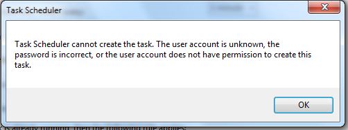

          On my Win 7 HP backup/test machine I did the following:
            [*]Created a Standard User account.
            [*]Logged on to the Standard User account.
            [*]Entered Task Scheduler and no tasks were present.
            [*]Tried to create a new task to run from the Administrator account which failed due to access restrictions.
            35627-TaskSch2

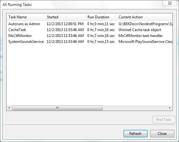

      I did a little more research and it seems that you can get a Scheduled Task to run in a Standard User account by setting it up in the Admin Account and doing the following:
      [List=1]
      [*]Goto C:WindowsSystem32Tasks find the related task.
      [*]Assign “read and execute” rights to the user you want to be able to access it.
      [*]Be careful to assign to “current object only”.
      [*]Then the task will be visible and runnable from the limited user and if you saved your credentials within it and checked “run whether user is logged on or not” – it will work.
      [/List]

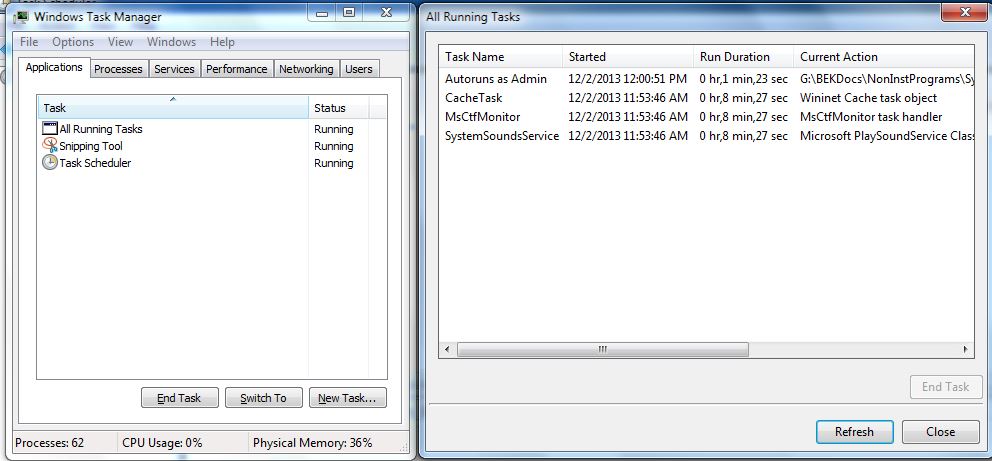

      Although this works in my testing: (starting SysInternals AutoRuns)
      35629-RunningTasks
      The task does NOT show in Task Manager and there is no access to the User Interface (no icon on the task bar and no window).
      35630-Taskmanager
      I had to kill the task from the Task Scheduler to get it to stop.
      Comments?
