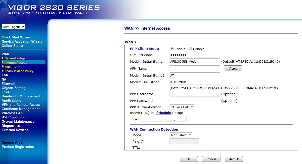

      • #1572938
        Hi Rick,
        I backed up the config for the router prior to doing an update of the firmware in the hope that it was a firmware issue, but alas, no joy, so I guess the settings are OK ?
        With dongle plugged into the router this is what it shows…
        45151-2016.08.01_17h51m53s_007_
        Graham

          At what point did you do the firmware update? Before or after the problem began?
          After the firmware update, did you ensure the WAN2 interface was (re)set to 3G USB Modem instead of Ethernet?
          • #1572945
            Hi,
            I did the firmware update after I started having problems as I thought that that may have been the problem. The WAN 2 setting was set at 3G modem as before.

    • #1572947
      Your screenshots show you don’t have any WAN connection/external IP on WAN2, i.e. the router’s hardware interface used by the 3G USB dongle… hence no internet.
      (Your screenshots also appear to show you aren’t at the latest firmware update (3.3.7.8). Perhaps the newest firmware update was a re-issue after reported problems with 3.3.7.5? I have no idea.)
      Your problem appears to be with your 3G USB modem/router interface – i.e. the USB port’s configuration in the router’s OS. Have you tried Draytek email support or in the Draytek support forum (if not answered by a Draytek Knowledgebase article)?

      Graham – I’m more than happy to be proven wrong but I still think it’s misconfiguration of the router’s WAN2 interface.
      In your first screenshot (post #5) there’s no APN name showing. Your router recognises that the USB dongle is using 3G (and initialises the hardware – the Modem Initial String) but other than that it’s pretty dumb. I understand that it may not need a username/password combo but surely the SIM needs the name of the carrier’s APN to know which carrier to connect to?
      I think that’s why the 3G USB dongle works fine in your PC and laptop… because the connection software provides the correct APN. I also think this explains why you have the same issue with both routers, even if you change dongle… the SIM isn’t being given the right carrier APN.
    • #1573077
      I guess an easy way to check is to compare your first 3 screenshots in post #5 with what they look like now.
      Anyway, glad to hear that it’s all working now.
    • #1573083
      The WAN > Internet Access screenshot showing WAN2’s APN setting is the important one. 🙂

      Yes, I hadn’t really appreciated the difference. The dongle came with scant generic information and I had to get the APN from a website.
