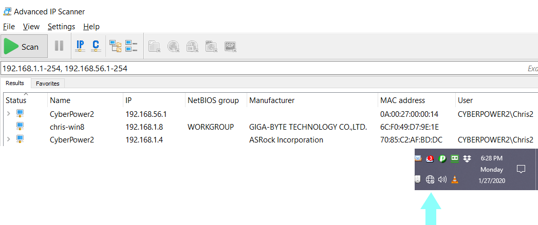

    I have 2 Win 10 1909 computers running 24/7. CYBERPOWER2 often shows No Internet Access in the system tray, but I think it really means not logged into my Windows account, even though I do log into it at bootup. (I do have internet access, but Windows apps like StickyNotes think I’m offline).
    If I reboot chris-win8, this usually solves the problem until I reboot CYBERPOWER2.
    See attached screenshot. What would cause CYBERPOWER2 to have 2 IPs and 2 MACs? CYBERPOWER2 is in WORKGROUP but is not shown as such in IP Scanner. What would cause this and is either symptom relevant to my problem?
    The 192.168.56.1 address is puzzling as I wouldn’t expect my router to have assigned it.
    IPs

    • #2111016
      Open Device Manager>Network Adapters to see if there are new network adapters you do not recognize and also check Network & Internet category in Settings. (If the Control Panel still exists look in the Network and Sharing Center.)
      Can you expand the greater than sign to see details in that utility?

      The one without a manufacturer name may be a virtual adapter. Do you have a VPN / virtual machine?
      We need info about the networks your machine using. Type this in a Command Prompt and post the output: route print
    • #2111055
      Thanks! My VirtualBox “adapter”, though not running, is responsible for the 192.168.56.1 address. I think this is unrelated to my problem.

    • #2111056
      Thanks. The earlier reply solved the adapter issue but not the “No Internet Access” problem.
      It’s interesting, though, that the “real” adapter doesn’t show WORKGROUP.
