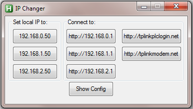

      For info: Whilst configuring devices on this family’s LAN I’ve encountered 192.168..1, 192.168.1.1 and 192.168.2.1 all used as default settings on devices such as router, powerline adapters, wireless range extenders and printers, etc. As a result I wrote a simple AutoHotkey GUI front-end to netsh so I could change network settings on the fly on the netbook I use for setup of these devices.
      38846-ip-changer
      Click to enlarge
      If anyone’s interested, my AHK script is:

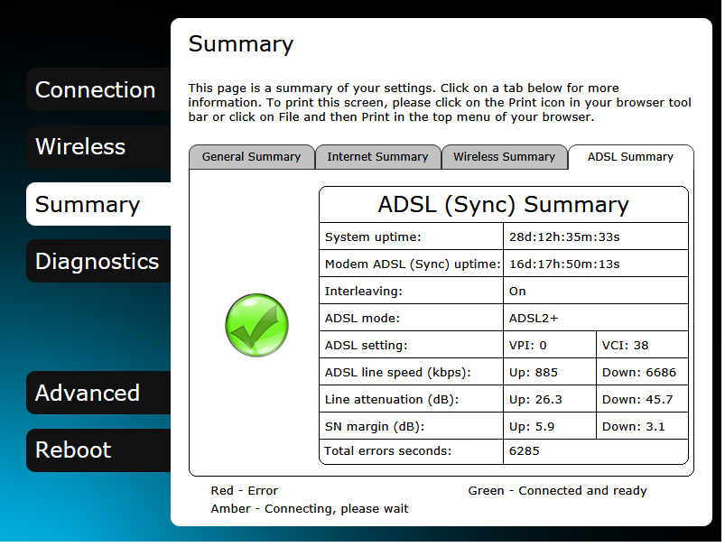

      A router can report a continuous up time but would have a different sync time where there has been a loss of connectivity.
      This is for my ISP supplied D-Link 3780.
      38848-ADSL-Sum
      Does this set up have a modem and router or is the TP-Link a modem/router combo.
      How many lights remain lit on the modem and/or router when these disconnections occur ?
      As the router reports Up even during a period of loss, perhaps the problem is internal interference and the router remains sync’d ?
      Running RouterStatsLite on one of the computers so that the SNRM and corresponding speeds are monitored can help with interference issues.

      Re, the query as to whether you are using a modem and router or if the TP-Link is a modem/router combo refers to if you have a two box set up from the master socket or just the router plugged in.
      TP-Links must work different to the routers I have used as when there has been a loss of Internet, just the Internet light has gone out and when there has been a loss of ADSL, all of them have gone out until it tries to resync.
      As the disconnects only seem to affect Internet and not the full ADSL connection, then I’m still leaning towards interference of which there can be a few.
