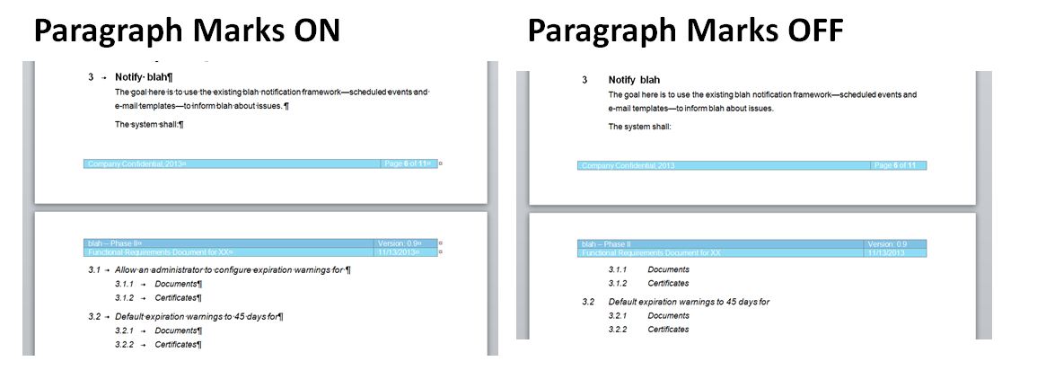

      Thanks everyone for your help thus far. For the most part, most everything is good. However, I am seeing the following weird behavior when I show or hide symbols.
      When symbols are shown, I see all the text I that I’ve typed. When symbols are off (which is preferred), some of my text is hidden. See number 3.1, notice how it disappears..
      I’ve never seen this before, and am curious if anyone else has ever seen anything like this.
      35443-Paragraph-Marks-Issue
    • #1422388
      Your 3.1 paragraph is behaving like it is formatted as hidden, but I don’t see any tiny dotted underline in your picture. Still, with formatting symbols showing, select the paragraph and press Ctrl+spacebar to clear the character formatting. Let us know if that works.
    • #1422786

      On the missing line question, it looks like the old problem where text near the top of a page randomly vanishes when in review mode – are you in that mode?
