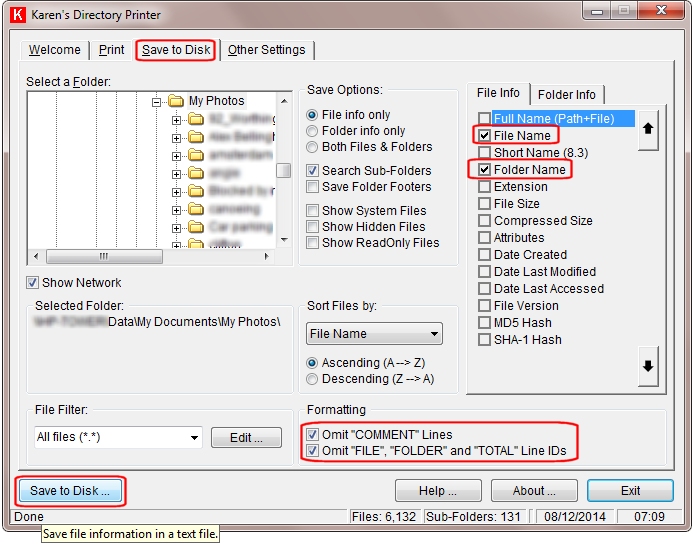

      I don’t know about a macro… it seems like you need a database and – in my opinion – with 3 million photos to index this is probably outside the scope of a forum like this. As a result, the following is a bit of a guess as I’ve only ever had to deal with about 120 thousand files before.
      Instead of searching different locations, I would create a data source per location then use these data sources to populate a database. I would use something like Karen Kenworthy’s Directory Printer (free) to save the file names and folder names as a .TSV (Tab Separated Value) file. I like this utility ‘cos it’s as easy to index network locations as it is to index local drives. Given the number of photos it’s going to take a while to generate the .TSV file per location.
      38642-dirprn
      (Click to enlarge)
