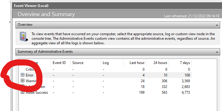

Are there any error entries in the “Summary of Administrative Events”? Expand the summary and post a screen shot (save as PNG and click the Select File button below the post).
WSSebastian42
AskWoody LoungerDecember 21, 2022 at 1:41 am #2510372I’m confused – you write : “EV logs probably won’t tell you anything” yet what you ask for seems to be an entry in Event Viewer. There are MANY error entries in the “Summary of Administrative Events”. Only a small portion can be caught in any one screen shot. Do you have advice on how the entire list – which covers about 12 hours or so – can be caught in one shot ? Secondly – wouldn’t it be more useful if the period included a ‘crash’ (whatever form it takes), or if the time of a recent crash was specified by me. MOREOVER, there seem to be errors listed when the PC was not running !
Paul T
AskWoody MVPDecember 21, 2022 at 1:58 am #2510377Those errors look typical for a functioning Windows system. Can you list only the errors via the plus in the summary pane?

AskWoody LoungerDecember 21, 2022 at 2:23 am #2510383Apparently I have the right pane, but nowhere do I see a reference to ‘summary’; more importantly, I cant see a ‘plus’ option in it anywhere.
WHY ‘enterprise device management software’ ? Are you saying that my Device Manager is (inappropriately) ENTERPRISE whereas my Windows10 is PRO ? I have no answer for you.
Even if I had a bad printer driver – why would it show when I rarely use the printer ? And it is normally unpowered, and insulated (?) from the system, through an individually switched 4 port USB hub.
‘What application is producing the error ?’ If you imply that my crashes occur because of one particular activity, it has not become obvious to me. As far as I can determine, crashes are totally random and unexpected. In any case, I posted an inquiry about the need for several attempts to have a successful boot. My frequent loss of mouse cursor may or may not be related – and while a solution would be welcome, it would be in the nature of a bonus.
I went back to search for a PLUs, and in the process discovered
1. ‘Sort by level’ which results in all the Errors showing first, then the Warnings. Individually and combined they still exceed the ‘real estate’ of a screen shot. Is there a away to capture ALL that information? I found a ‘save selected events’ but that has an extension which I don’t know how to open to see what it captured. OK it opens in Event Viewer – but comprises just one entry.
2. I have also found the references to Enterprise : DeviceManagement-Enterprise-Diagnostics-Provider and Log Name: Microsoft-Windows-DeviceManagement-Enterprise-Diagnostics-Provider/Admin

AskWoody LoungerDecember 21, 2022 at 3:51 am #2510401I can see you have achieved a Summary view in Event Viewer Local, but have no idea how to navigate there myself.
I have managed to do a ‘sort’ in Administrative Events which lists numerous ‘critical’ (all Kernel Power), followed by numerous ‘errors’, followed by numerous ‘warnings’.
I’d love you to see them all, but need guidance opn how to capture those lists.
In the errors, I found a ‘DeviceManagement-Enterprise, clciked on it and a window opened whose snapshot is appended, but I’ve also pasted HERE the results of clicking ‘copy’ in that window. Since it is so bulky, and printing works perfectly well, I’ll leave the printer till you ask for it again.
