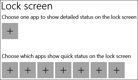

        Windows 10 Pro 22H2 /w April updates (no problems encountered installing the updates.)
        1. Do you now have the option for prompts on the lock screen? The option is supposed to be at Settings | Personalization | Lock Screen.
        Yes but it looks like this and, if I click any of the + prompts, it shows no apps available to be added.
        LockscreenApps
