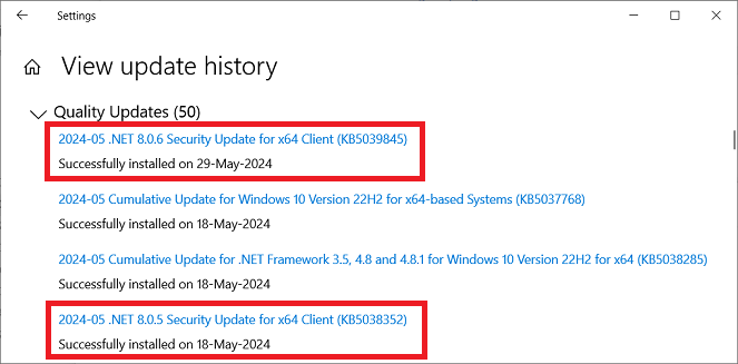

      If 6.0.31 has security fixes and 6.0.30 does not, it seems that it would be wise to install 6.0.31.
      I agree with WCHS  and Bob99.
      I have a Win 10 Pro OS and use the Local Group Policy Editor to prevent Windows Update from delivering Preview updates. I have the Microsoft Windows Desktop Runtime v8.0.x installed on my computer and Windows Update automatically delivered .NET Runtime v8.0.6 on 29-May-2024 (see image below), so I assume the three .NET Runtime updates listed in KP’s 31-May-2024 post # 2676868 (v6.0.31 / v7.0.20 / v8.0.6) were out-of-band security updates and not Preview builds.
      Win-10-Pro-v22H2-Windows-Update-History-NET-Runtime-v8_0_6-Out-of-Band-Security-Update-29-May-2024
      Dell Inspiron 15 5584 * 64-bit Win 10 Pro v22H2 build 19045.4412 * Firefox v126.0.1 * Microsoft Defender v4.18.24050.7-1.1.24050.5 * Malwarebytes Premium v5.1.5.116-1.0.1252 * Macrium Reflect Free v8.0.7783
