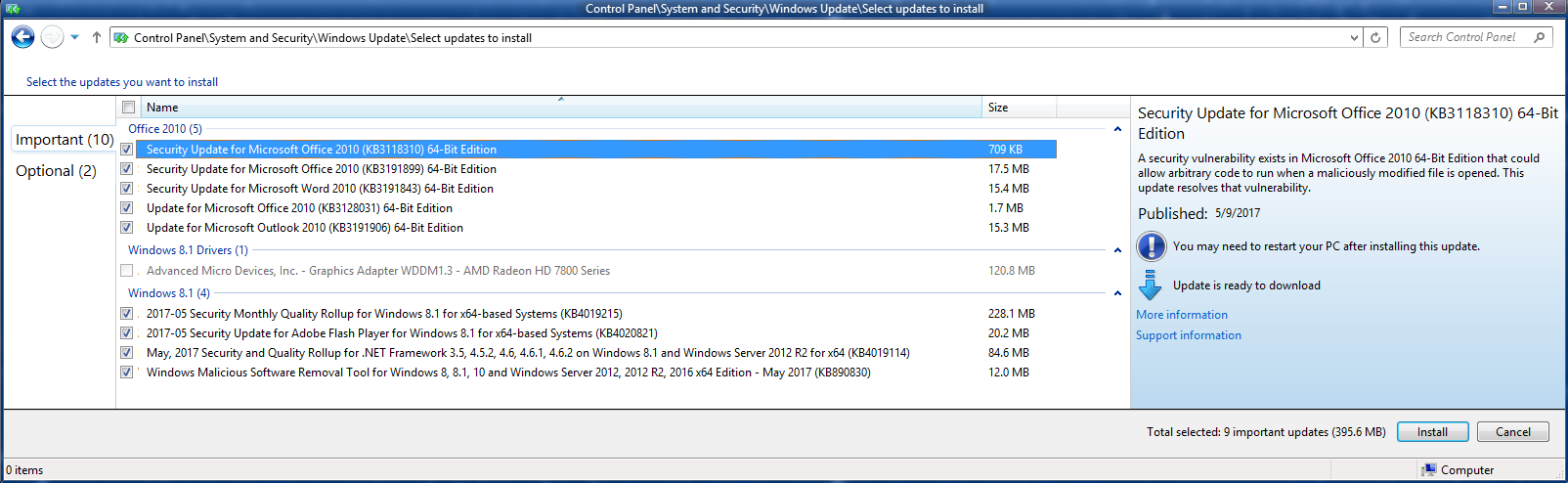

      A Win 8.1 data point:
      We appear well-synchronized in our judgment, Woody… I completed testing on my Win 8.1 virtual machine and chose to move my critical Win 8.1 workstation up to the May “Group A” patches today.
      The Important updates listed as available follow. I hid the driver update (I no longer even have an ATI card) but chose to install all the others:
      ListedUpdatesMay2017-1
      The optional updates that were offered are shown here. I did not install these.
      ListedOptionalUpdatesMay2017-1
      After the updates went in I tested and benchmarked the hardware system and have found Win 8.1 is still apparently stable, with performance unaffected.

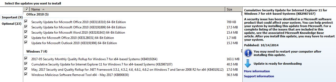

          Win 7, Group B –
          What about the Office Updates?  There were two “newer” ones that came out after I finished the April updates.  One of them appears to still be there.  Are they okay now?
          Also, I’ve got a Cumulative Security Update for Internet Explorer 11 which is dated 10/14/14!
          May-WU-snip
          • #117723
            If the Office updates are checked, go ahead and install them.
            The old update for IE is there because the supersedence chain for it was broken when MS retired a mass of old updates recently. It will eventually disappear if you leave it alone, but if it gets installed it won’t hurt anything.

      Everything worked well until this month.
      After patching for May 2017, Windows Update says I should install KB2813347 (from 2013) and KB2987107 (from 2014). Belarc Advisor says I should install KB3126446 (from 2016), KB3212642 and KB4019108.
      KB3212642 is the January 2017 security only update that I installed in February. I tried reinstalling KB3212642, but I get a “update is not applicable to your computer” message.
      KB4019108 is the May 2017 DotNet security only update, but I already installed the May 2017 DotNet rollup.
      I read about the “supersedence chain” issue in another thread. Very confusing.
      • #117538
        You can skip this one. It shows up because the supersedence chain was broken when MS retired the mass of patches recently.
        This fixes MS13-029. Go ahead and install. If it’s there because of broken supersedence, it won’t hurt anything.
        If it shows already installed, don’t worry about this one.
        You can try to install this if you want to. But it probably won’t install since you have the May Rollup already installed. It may be showing up because of incomplete supersedence.

      I just completed Group B instructions: from the initial downloads of the 2 May updates for Windows 7 and IE, until the final restart, took 44 minutes.
      There were 8 Important and 2 Optional Updates, of which 7 Important and 0 Optional were installed.
      Thank you very much, once again, for such clear and easy-to-follow instructions — making this such a painless process.

    • #117865
      The times are a-changin’. Last October, Microsoft started lumping together all of its Windows 7 and 8.1 patches. Before October, we had separate patch[See the full post at: MS-DEFCON 3: Get patched and brace yourself for a Malware-as-a-Service future]
      Thanks, Woody. I just checked for updates and there were six available. Two were unchecked.
      These were checked:
      2017-05 Security Monthly Quality Rollup for Windows 7 for x64-based Systems (KB4019264)
      Cumulative Security Update for Internet Explorer 11 for Windows 7 for x64-based Systems (KB2987107)
      May, 2017 Security and Quality Rollup for .NET Framework 3.5.1, 4.5.2, 4.6, 4.6.1, 4.6.2 on Windows 7 and Server 2008 R2 for x64 (KB4019112)
      And Windows Malicious Software Removal Tool x64 – May 2017 (KB890830)
      These 2 were unchecked:
      Microsoft .NET Framework 4.6.1 for Windows 7 for x64 (KB3102433)
      and
      Update for Windows 7 for x64-based Systems (KB3021917)
      Does that look right?
      Morty
      • #117867
        Leave the unchecked updates unchecked.
        The update for IE is old. you can uncheck it and not install – it will eventually go away. But if it gets installed it won’t hurt anything.
        Get patched.
    • #117868
      Leave the unchecked updates unchecked. The update for IE is old. you can uncheck it and not install – it will eventually go away. But if it gets installed it won’t hurt anything. Get patched.
      Will do. Much appreciated.
      Morty
