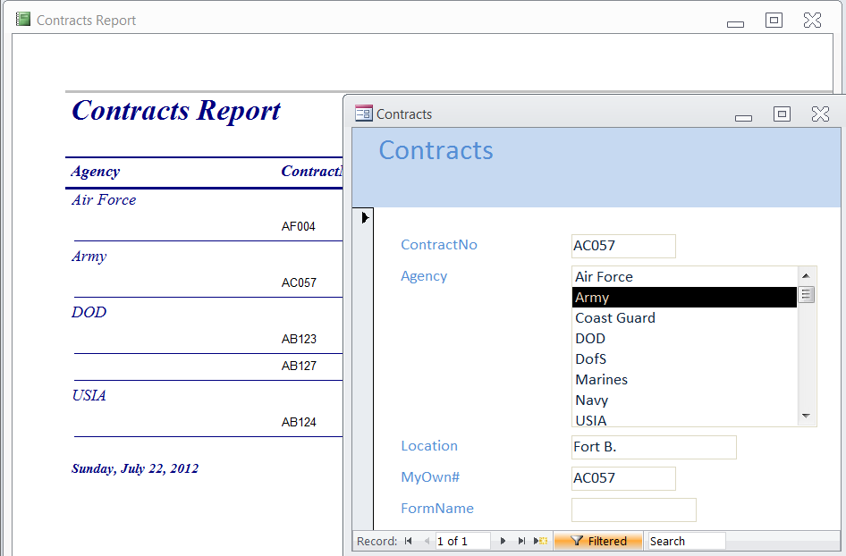

      You can do this with a regular report by using the Click event on the ID field with code like this:
      Code:
      Private Sub ContractNo_Click()
                 DoCmd.OpenForm "Contracts", acNormal, , "ContractNo = " & _
                            Chr(34) & Me.ContractNo & Chr(34)
      End Sub
      Note: the Chr(34)’s are only necessary if the ID value is a string type.:cheers:
