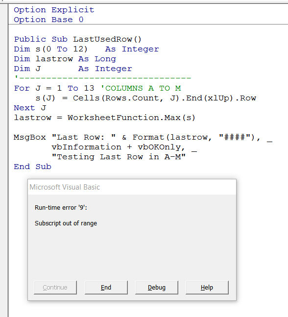

      I just ran across something that has me sort of baffled.
      In your post #2, I said well that shouldn’t work unless there is an Option Base 1 command that isn’t shown. But then I said, Maud wouldn’t leave an important thing like that out so I thought I’d test it.
      Well it seems that the Option Base command has been removed, more exactly no longer has any effect as it doesn’t cause an error if present.
      I tried your code with both Option Base 1 & Option Base 0 with out affecting the outcome of the code.
      So I thought, is it because of the Variant data type? So I changed it to an integer and low and behold still not errors with either Option Base, e.g. at Option Base 0 a 13 position array should be 0-12 and referencing position 13 SHOULD cause an subscript out of range error. It just ain’t so.
      You can still get a zero based array but you have to do it in the Dim statement, e.g. Dim s(0 to 12) as Integer. Which will generate the error:
      45019-VBA-Subscript
      I did find one vague reference to Option Base being removed from the language when they went to .net but that was it as far as my Googling went.
      Can anyone else shed any light on this?
      BTW: all testing done with Excel 2010.
      :cheers:

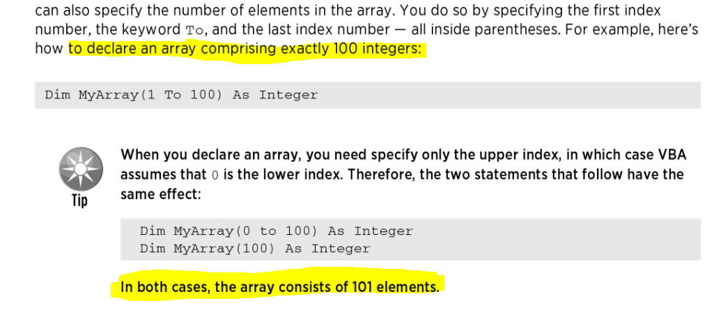

      I just found this in “Excel 2010 Power Programming with VBA”, By John Walkenbach
      45020-VBAArrays
      That sure explains a lot…Who knew? Not me that’s for sure!
      That will sure change how I declare arrays in VBA going forward.
    • #1570722
      Per the VBA Language specification for Array Dimension and Bounds (sect 5.2.3.1.3):
      array-dim = “(“ [bounds-list] “)”
      bounds-list = dim-spec *(“,” dim-spec)
      dim-spec = [lower-bound] upper-bound
      lower-bound = constant-expression “to”
      upper-bound = constant-expression
      Static Semantics
        [*]An <array-dim that does not have a <bounds-list designates a resizable array.
        [*]A may contain at most 60 elements.
        [*]An with a designates a fixed-size array with a number of dimensions equal to the number of elements in the .
        [*]The in an or must evaluate to a data value that is let-coercible to the declared type Long.
        [*]The upper bound of a dimension is specified by the Long data value of the of the that corresponds to the dimension.
        [*]If the is present, its provides the lower bound Long data value for the corresponding dimension.
        [*]If the is not present the lower bound for the corresponding dimension is the default lower bound for the containing module as specified in Section 5.2.1.2.
      For each dimension, the lower bound value must be less than or equal to the upper bound value.
      Note that the lower bound is optional, the upper is not.
      Hence, any array declaration that only provides one number for a dimension, is providing the upper boundary, as Maud said, not the number of elements, which will be dependent on the Option Base.
