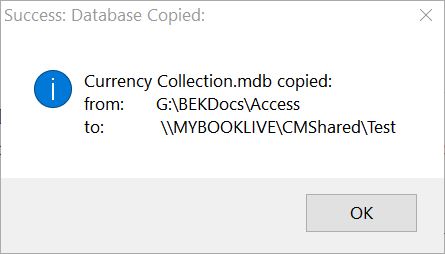

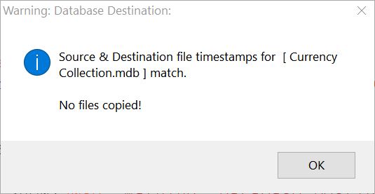

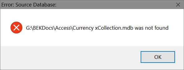

      Here’s some code I use to keep front-ends up to date with the Back-End.

      So here’s the PowerShell version. It’s a good example why you would want to use PS over the old Batch language.
      Code:
      Clear-Host
      $Src  = [COLOR="#0000FF"]"G:BEKDocsAccess"[/COLOR]
      $Dest = [COLOR="#0000FF"]"\MYBOOKLIVECMSharedTest"[/COLOR]
      $DBN  =[COLOR="#0000FF"] "Currency Collection.mdb"[/COLOR]
      Add-Type -AssemblyName PresentationFramework
      $Buttons = [Windows.Forms.MessageBoxButtons]
      #Values: OK, OkCancel, AbortRetryIgnore, YesNo, YesNoCancel, RetryCancel
      $MBIcons = [Windows.Forms.MessageBoxIcon]
      #Values: None Question, [Stop | Hand],
      #        [Warning | Exclamation], [Information | Asterisk]
      $MsgBox = [Windows.Forms.MessageBox]
      Try {   #Check existance of the source front end database
        $SrcDate  = (Get-ChildItem -Path "$Src$DBN" -ErrorAction Stop).LastWriteTime
      Catch {
         $MsgBox::Show("$Src$DBN was not found","Error: Source Database:",
                       $Buttons::OK, $MBIcons::Stop)
        Exit
      #Check the existance of the destination directory.
      If (-not (Test-Path -Path "$Dest")) {
        $MsgBox::Show("Destination path [ $Dest ] does not exist!",
                      "Error: Database Destination:",
        Exit
      Try { #Check existance of the FE database at destination location
         $NoDestFile = $False
         $DestDate  =
          (Get-ChildItem -Path "$Dest$DBN" -ErrorAction Stop).LastWriteTime
      Catch {
        Write-Host "$Dest$DBN was not found"
        $MsgBox::Show("FE Database does not exist at:`n" +
                      "[ $Dest ]`n`nFile will be copied!",
                      "Warning: Database Destination:",
                      $Buttons::OK, $MBIcons::Information)
        $DestDate = 0
        $NoDestFile = $True
      If (($SrcDate -gt $DestDate) -or $NoDestFile) {
        Copy-Item -Path "$Src$DBN" -Destination "$Dest$DBN" -Force
        $MsgBox::Show("$DBN copied: `nfrom:`t$Src`n" +
                      "to:`t $Dest",
                      "Success: Database Copied:",
      Else {
        $Msg = "Source & Destination file timestamps for " +
               " [ $DBN ] match.`n`nNo files copied!"
        $MsgBox::Show($Msg,"Warning: Database Destination:",
      Copy the file into notepad and save as “Update-AccessFEDB.ps1” include the quotes so Windows doesn’t change the file type to .txt!
      To run from a shortcut set the target to: C:WindowsSystem32WindowsPowerShellv1.0powershell.exe -File “C:UsersUserIDDocumentsScriptsUpdate-AccessFEDB.ps1″
      Change blue parts to match your machine and where you saved the file! Don’t forget to change the script parts in blue with your data!

    • #1591120
