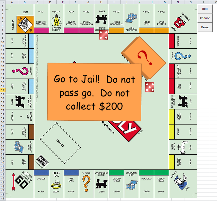

    • #1511695
      zeddy
      Here is my game board. I see the entire board at 90% and just the lower edge is missing at 100%. If I had a preference, the dice would come in from the lower left and rest somewhere in the center of the board.
      Now if a dice happens to accidently go off the table, we’ll just have to roll again.
      B.

    • #1512903
      Hey Zeddy,
      Nicely done!! While you were working on animating the game pieces, I was working on animating the picking of a chance card. Click the Chance button and the top Chance card will slide off the top of the pile, rotate 3-D and display the message. The Reset button places it back in the pile.
      XLD, you will have to add the code to the SetText Routine to select the message to display on the card.

      • #1513174
        Hi Brian
        This is it so far..
        ..I tweaked Maud’s code, and added some Chance cards.
        ..haven’t done anything on moving pieces.
        Some time ago I did a post that ‘translated Excel sheets and tabs’ according to language selected.
        I used the same technique for the ‘flags’ alongside the Board.
        Click and see the results.
        zeddy

      • #1513024
        Hi Brian
        ..please keep this thread open. I’m tweaking some more stuff. Maud’s twirling cards are magnificent.
        zeddy

      • #1514481
        Hi Brian
        ..glad you liked the flags. I figured with you in Vancouver, Maud and RG in the USA, and me currently in UK, it would make it more interesting to have familiar names on the Board.
        I have been playing with moving pieces on the Board. Currently, I have the dog hopping from square to square (along, up, across and down etc etc). I thought it would be nicer to have the pieces ‘move’ on the squares, rather than just ‘beam-up-scotty’ to the destination square.
        Will post an updated copy when I’ve linked the moves to the dice throw. Maybe tomorrow.
        zeddy

        Hi Brian
        Here’s the progress so far. I added Maud’s card-pointer for the Chance cards. Great idea.
        I’ve linked the dice to player, and to move their corresponding piece.
        I have not done anything with regard to the rules, i.e. if player lands on ‘Goto Jail’, I haven’t implemented that. Or if a player lands on Chance etc etc etc. Also, I haven’t done anything with regard to collecting money as you pass Go etc, or purchasing of property, or collecting rent etc etc.
        At some stage, we would need to see what other Players ‘have’, in the way of money, property, houses etc. So I added a sheet [B]Players[/B] where this info could be kept. And, using Excel’s camera tool, I took a ‘snapshot’ of this Player data-block, to show as a ‘picture’ on the main Board, when you click the [Show/Hide Player info] button.
        So, more input from others then?
        zeddy

    • #1514721
      XLD,
      Here is the code for the Community Chest Cards. You can see the objects you will need to copy over in the selection pane. If you need help, zeddy and I as well as the rest of the forum are ready to jump in. Post the game when you get it completed.
      Maud
