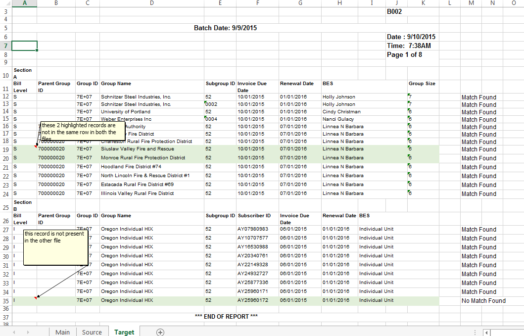

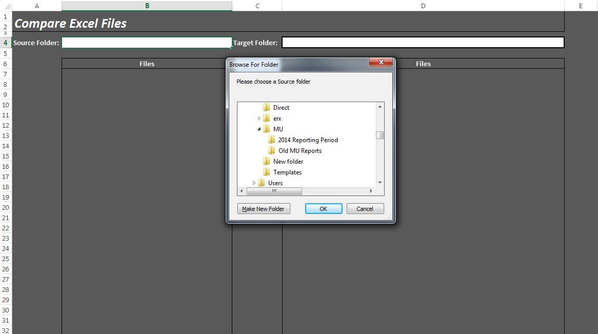

    • #1535252
      prassannacts,
      If unclehewie’s nicely prepared spreadsheet does not fit your needs, consider this spreadsheet. The spreadsheet opens to a main screen where the user initially clicks on the source and target boxes to navigate and select the paths. This will need to be done only once if the paths do not change. The spreadsheet remembers.
      42455-GetPath
      Once the paths have been selected, the columns will populate with *.xls files in that folder. If new files have been added to the folders, the user can update the list by clicking the Update Files button. The user then selects one of the files in the source column. If there is not a matching file in the target folder, the user is notified.
      42456-NoMatchingFile
      If the user selects a source file that has a matching target file, the font will turn red for both files and the Compare button will now be enabled
      42457-Matching-File
      When the user clicks the compare button, the selected files are pulled into the spreadsheets as Source and Target worksheets and a bi-directional comparison is made. Matching records (“Match Found”) will be indicated in column M on both sheets. For source records that do not have a matching target record, “No match found will be listed in column M on the source sheet while any record in the target sheet that does not have a match on the Source sheet will have “No Match Found” in column M on that sheet.
      Source:
      42458-source
      Target:
      42459-Target
      Going back to the Main sheet, selecting a new pair, and clicking the Compare button will import both new sheets and overwrite the Source and Target sheets. The original sheets will never be altered.
      Created in Excel 2013, converted to 2003. There were no issues when tested in 2010.
      HTH,
      Maud
