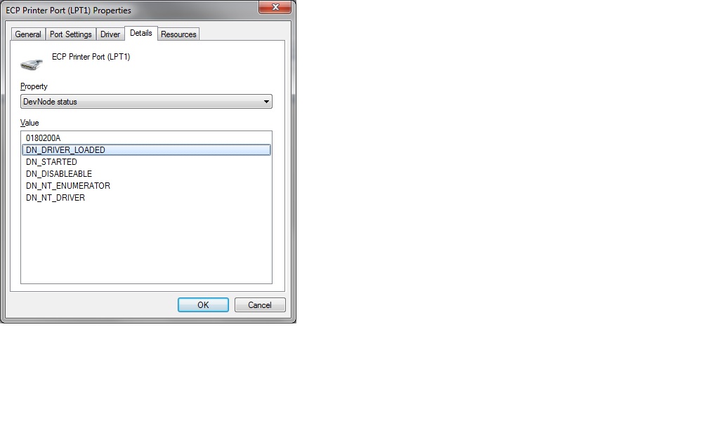

      I’ll go out on a limb here and suggest a re-look at the printer cables. The latest cables were marked with IEEE-1284 and generally were required as newer printers came out “back in the day”. As I recall there were 3 settings in the BIOS of computers as to the capability of the parallel-port/LPT1 such as ECP. These things could drive a person up the wall when not set right.
    • #1588428
      What you are doing here is real old school. It should be backwards compatible, but that’s in theory only. Even “advanced” parallel port capabilities (EPP and ECP) go back a long, long way.
      Here are my suggestions.
      1). The old rules required a colon after every device name. It’s safer to use those because that is unambiguous to the command interpreter. Without them the command interpreter has to fall back to reserved file names for devices, and those rules may have changed with NTFS. Thus, the console device is CON: and not just CON, the first parallel port is LPT1: and not just LPT1, and so forth;
      2). Showpage command? I thought that was PostScript only? I’m not aware of any PCL Showpage command. Even if there is a PCL Showpage, it would have to be bracketed by Escape characters. In PCL all data in the datastream is considered printable by default. You use Escape characters to “escape” into command mode, then “escape” a second time to leave command mode. PostScript is the opposite. All data in the datastream is considered to be commands by default. There are PostScript commands (I don’t know what they are) whose purpose is to define and encapsulate printable data;
      3). Both PCL and PostScript got “one-upped” by a meta-language called Printer Job Language, or PJL. This happened because dual PCL and PostScript printers became commonplace, and switching back and forth became a problem. PJL solved these problems, but I spent several fun years with dual rendering language printers and no PJL. PJL was a godsend! Note that PJL did not replace PCL or PostScript, it enhanced and added to them;
      4). Your [Ctrl-Z] should pass through the session OK. I don’t see a problem with that one;
      5). You may need to alter Windows EPP, ECP, or interrupt support. I’ll post my settings in a separate message (this is getting long).
