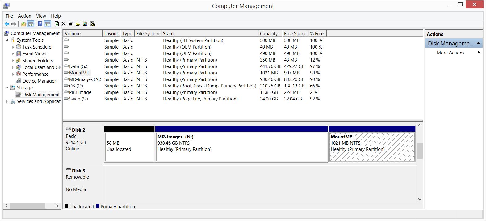

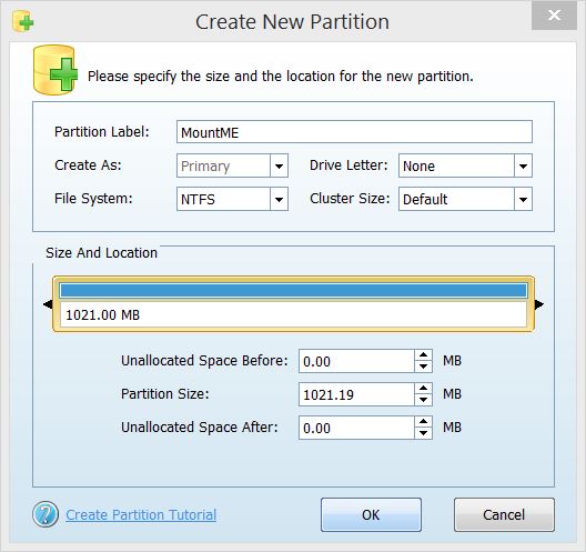

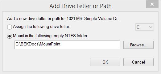

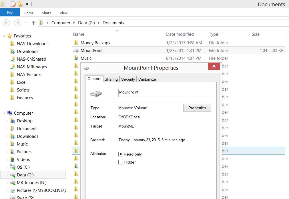

      Hey Y’all,
      Here’s how it’s done.
      First I created a 1Gb partition and did not assign it a drive letter.
      39070-NODLPartition
      Confirm in Disk Management that there is no drive letter.
      39071-Confirm-Mount
      Use Disk management to mount the partition.
      39072-EstMountPoint
      This is how it looks in File Explorer
      39073-IE-MountPoint
    • #1486185
      It works! Even in XP. Amazing the things you just don’t notice, or did I forget ? 😮

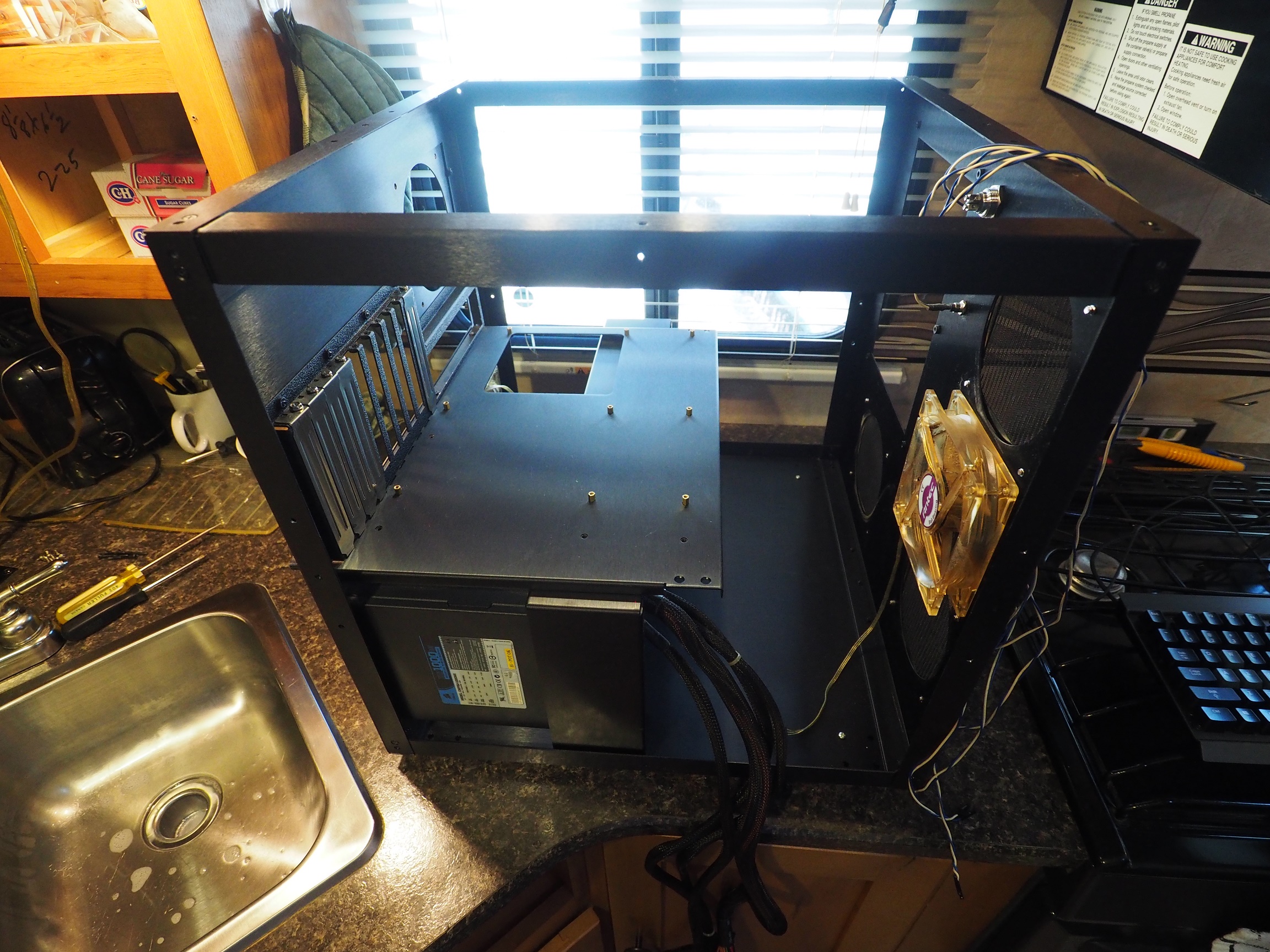

      • #1486445
        CLiNT,
        That’s some case! Did you get “WOPR” etched into one of the panels?
        If I might ask where did you get the mortgage for it? 😆
        Seriously, how about some pics of that babe in action? :cheers:
        Hell no, that would have add a few hundred dollar to the mix.
        Here’s a pic of it naked:
        OLYMPUS DIGITAL CAMERA
        If I can get the board I want in the coming months, I’ll go over the build in more detail in a separate thread.
        The ASUS X99 Deluxe board I’m using right now was supposed to be my backup motherboard. What I really wanted was the ASUS X99 E WS.

      Is it next to the sink in case it overheats?
      No. I live in my 26 foot travel trailer where space is at a premium.
      It’s also next to the sink because I just washed all the dust out.
      CLiNT,
      With a $300 case a $500 MB and I’d assume a $500+ (i-7) processor and from reading the MB specs I’d assume SLI/CrossFire video cards it’s looks like you’ll need that mortgage!
      Thanks for the pic. Looking forward to the full build story & pics.
      No mortgage, but I did budget for it. The case actually cost me around 600.00 custom built.
      I got the case about a year ago and rebuilt my old X58 system into it. I was fully anticipating
      a future X99 chipset build, so the 4 grand that went into it was “saved up” the old fashion way.
      One of the problems on the case side of things was that I didn’t anticipate a radiator 120mm x 2 size, so I have to
      get a replacement side panel that can accommodate the new radiator. It’ll run about 80 dollars.
      I’m probably on the very edge of deciding whether full liquid cooling is worth it over these closed unit cooler that are on the market these days.
