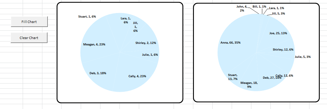

    Hi All,
    Does any one know if there is away to format pie wedges based on predetermined colours so that when comparing 2 charts with similar data (in this case names) that the colour of the wedge for a name is the same in both charts, regardless of whether all names appear in both charts?
    I hope that makes sense – the attached may help explain further.
    Thanks in advance for any thoughts/assistance

      Hi Zeddy,
      Thanks for your help with this. That works Ok, but sort of defeats the purpose to have the pie wedges the same colour in both charts for the individual.
      Rather than getting the colours from [T] is it possible to match the name colours in [AA] and [AH] with those in [T]? I guess a bit like a conditional format where if the name, say = Lara in [AA] or [AH] and the corresponding cell colour (orange in T5) that way the names would always have the same wedge colour (based on the previous code).
      Hope that makes sense

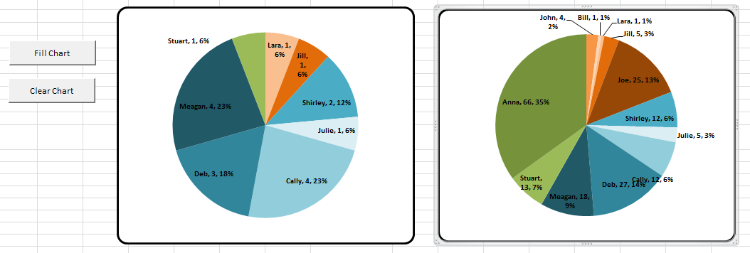

    • #1510230
      Verada,
      Try this to see if it meets your needs.
      Maud
      Prior to code run:
      41050-Verada1
      After code run:
      41051-Verada2
      Code:
      Public Sub PieColors()
      Dim Cht1 As Object, Cht2 As Object
      Dim I As Integer, J As Integer
      Set Cht1 = ActiveSheet.ChartObjects(1).Chart.SeriesCollection(1)
      Set Cht2 = ActiveSheet.ChartObjects(2).Chart.SeriesCollection(1)
          For I = 1 To Cht1.Points.Count
              FillPoint 1, I
          Next I
          For J = 1 To Cht2.Points.Count
              FillPoint 2, J
          Next J
      End Sub
      Public Sub FillPoint(ByVal ChtNum As Integer, ByVal num As Integer)
          ActiveSheet.ChartObjects(ChtNum).Activate
          Label = Split(ActiveChart.SeriesCollection(1).Points(num).DataLabel.Text, “,”)
          Row = WorksheetFunction.Match(Label(0), [T2:T14], 0)
          ColorValue = Cells(Row + 1, 20).Interior.Color
          ActiveChart.SeriesCollection(1).Points(num).Interior.Color = ColorValue
      End Sub
    • #1510233
      Thanks Maud – that looks to do exactly what i need.
      Much appreciated
