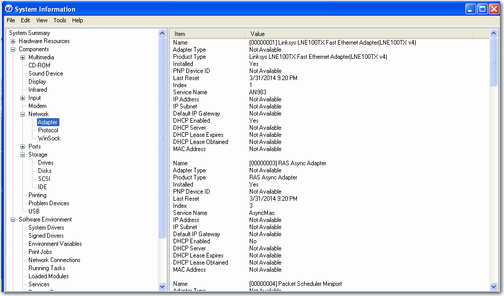

        Sudo15: You wrote “You will be able to confirm its RTL number in msinfo32/Components/Network/Adapter prior to downloading.” I went to the msinfo32 link and the Realtek Ethernet Controller was not listed, at least I could not find it. Here is a screenshot of that section of msinfo32:36675-Screenshot-of-msinfo32-Components-Network-Adapter-033114. It is interesting to note the Linksys LNE100TX Fast Ethernet Adapter was the plug in Ethernet Adapter card used in the previous motherboard and not installed in new motherboard (because of built in adapter in new motherboard). See “history of configuration” write up.

      Is the Linksys driver still showing as installed in Programs and Features ?

      You should find the Realtek drivers in System32/drivers listed as rtl items, but reading through the History of configuration, the Found new hardware should have been accepted as you have rejected the installation of the Realtek GBE Family Controller and from http://support.microsoft.com/kb/307736 would seem that you need the NIC1394, but if it finds new hardware to what it previously had, then you should accept the installations and is probably why it can’t find the folder to stick the Ethernet driver into and probably why the Realtek GBE isn’t listed in msinfo32.
      I don’t know why the Linksys was still showing unless that driver is still installed, but you didn’t answer if that driver was still listed in Programs & Features.
      The new found hardware can’t be from your old motherboard when that is no longer in the pc.
      What happens in Device Manager when you go Action/Scan for hardware changes ?
