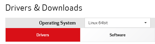

          Go to the downloads site, and pull down the Operating System selection.
          Linux
          Post Link: https://www.askwoody.com/forums/topic/linux-mint-19-1-wireless-printer-issues/#post-1939182
          But – I don’t see it here! Strange. Second one that wasn’t visible – see below. But yes – I think that looking into the driver maybe be the solution! I will post back later or in the morning with my progress! Thanks!!
          • #1939431
            Yes, my bad. After posting, I realized that there is no Linux download listed, so I edited the post and cleared the text. (Delete function has been withdrawn.) Since the post is gone I would posit that a moderator properly did a delete, and it no longer exists. Fingers overrun vs. comprehension. Sorry.

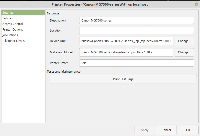

              Thanks so much for these guides – I will read them over. I haven’t downloaded the driver yet – this is all just a bit over my head – LOL – since I am pretty new to Linux, but the guides will surely help.
              I did recheck and the printer works fine when attached with the USB cable to the laptop. I am wondering if perhaps the fact that I installed the same printer twice – once as a wired printer back when I was first testing Linux several months ago, and then again as a wireless printer when I started using Linux again last week.  Would having the same printer “installed” both ways be part of the issue? And I wonder if there is a way to just make the initial install also be able to be accessed wirelessly. I know – very confusing!
              Screenshot-from-2019-09-06-14-54-56
              Or maybe that wireless printer needs to be uninstalled and reinstalled using a different process – I think I just “added” that printer from that same dialog box.

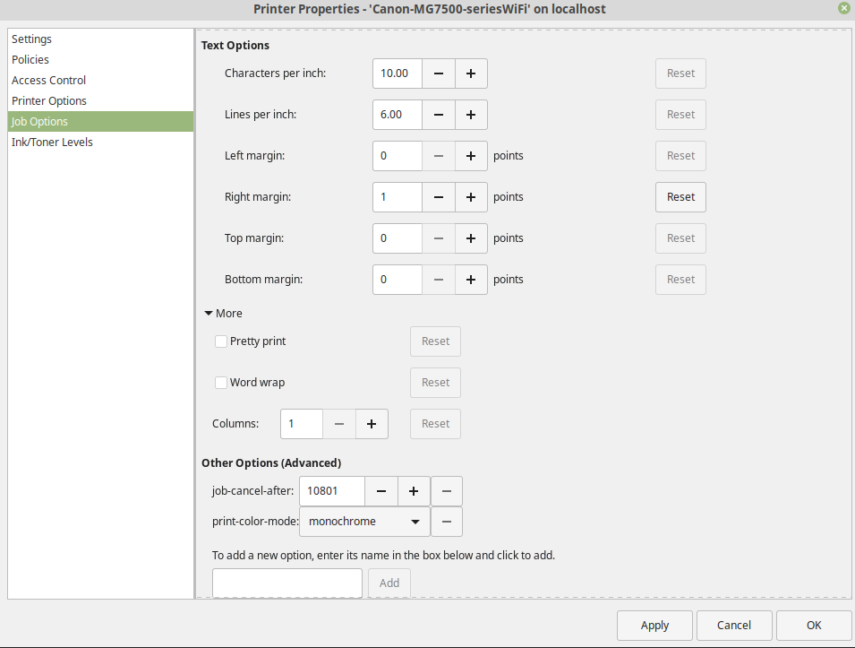

      Some questions I forgot to ask: You did not see any options for paper saving or multi-page printing? What did the Settings and Job Options tabbed dialog box have in them?
      • #1941066

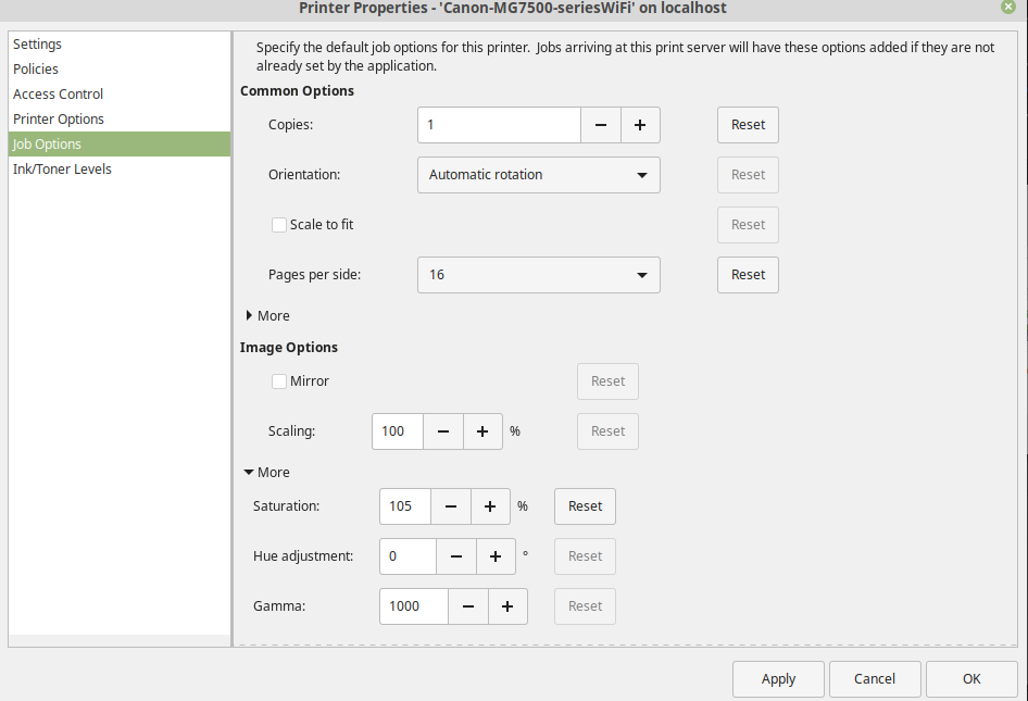

        Neither of those paper saving settings:
        Job-options-1
        Job-options-2
        Settings
        • This reply was modified 5 years, 8 months ago by LHiggins.
        • #1941085
          Under Common Options Pages per side is set to 16 it should be 1, that is yet another different term for that… Try print a new page, it should be normal after saving the change.
          • #1941131
            Hallelujah! That was it! It worked great – once I changed that 16 to 1! Perfect – I can’t say how much I appreciate your help! Such a simple thing – and something that I will definitely keep an eye on in case it changes mysteriously!
