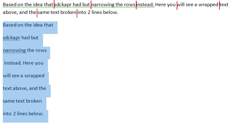

AskWoody_MVPAugust 23, 2012 at 8:09 pm #1346839Actually, not too bad. Copy the contents of the cell by highlighting the text then copy it. Note where the text wraps on the first line. Copy it into Word. Place the cursor after the text you noted where the wrap began in Excel. Press enter. Place the cursor after the word that is about the same length as the first and press enter again. Keep going making new lines all about the same length as the first. Copy the text noting the number of lines and paste back into excel using the number of verticle cells same as the number of lines in Word. The “enter” that you added after each line in Word will force each line into each verticle cell. Now just reduce the height of the rows and you are done. HTH, Maud
31843-Excel_wrapped31841-Word_lines-separated31842-Excel_pasted -
