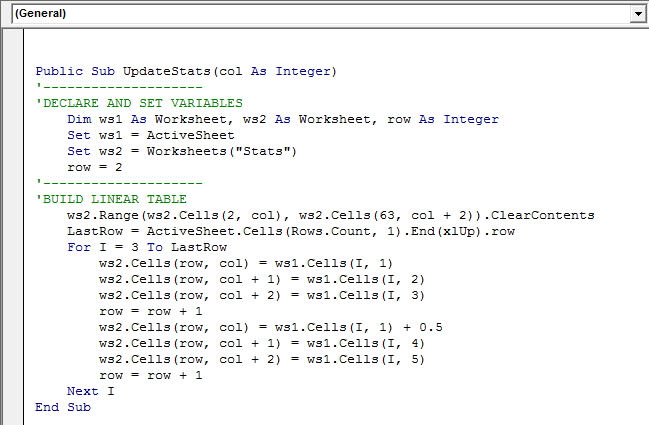

MaudSample code prior to running “AddLineNums”:
42718-Mike1Sample code after running “AddLineNums”:
42719-Mike2Code:Public Sub AddLineNums() [COLOR=”#008000″]’————————————– ‘DECLARE AND SET VARIABLES[/COLOR] Dim Procedure As CodeModule, Code As String, Module As String, Proc As String Dim StartLine As Long, EndLine As Long, LineNum As Integer, I As Long [COLOR=”#0000FF”]Module = “Module1”[/COLOR] [COLOR=”#008000″]’CHANGE TO MODULE NAME[/COLOR] [COLOR=”#0000FF”]Proc = “UpdateStats” [/COLOR] [COLOR=”#008000″]’CHANGE TO PROCEDURE NAME[/COLOR] Set Procedure = ThisWorkbook.VBProject.VBComponents(Module).CodeModule StartLine = Procedure.ProcBodyLine(Proc, vbext_pk_Proc) EndLine = Procedure.ProcCountLines(Proc, vbext_pk_Proc) – StartLine LineNum = 10 [COLOR=”#008000″]’————————————– ‘CYCLE THROUGH LINES OF CODE[/COLOR] For I = StartLine To EndLine [COLOR=”#008000″]’————————————– ‘EXCLUSIONS[/COLOR] If InStr(1, Procedure.Lines(I, 1), “Sub”, vbTextCompare) > 0 Then GoTo NextLine If InStr(1, Procedure.Lines(I, 1), “Function”, vbTextCompare) > 0 Then GoTo NextLine If I > 1 Then If Right(Procedure.Lines(I – 1, 1), 1) = “_” Then GoTo NextLine End If [COLOR=”#008000″]’————————————– ‘ADD LINE NUMBER[/COLOR] Procedure.ReplaceLine I, LineNum & Chr(9) & Procedure.Lines(I, 1) LineNum = LineNum + 10 NextLine: Next I [COLOR=”#008000″]’————————————– ‘CLEANUP[/COLOR] Set Procedure = Nothing End Sub
