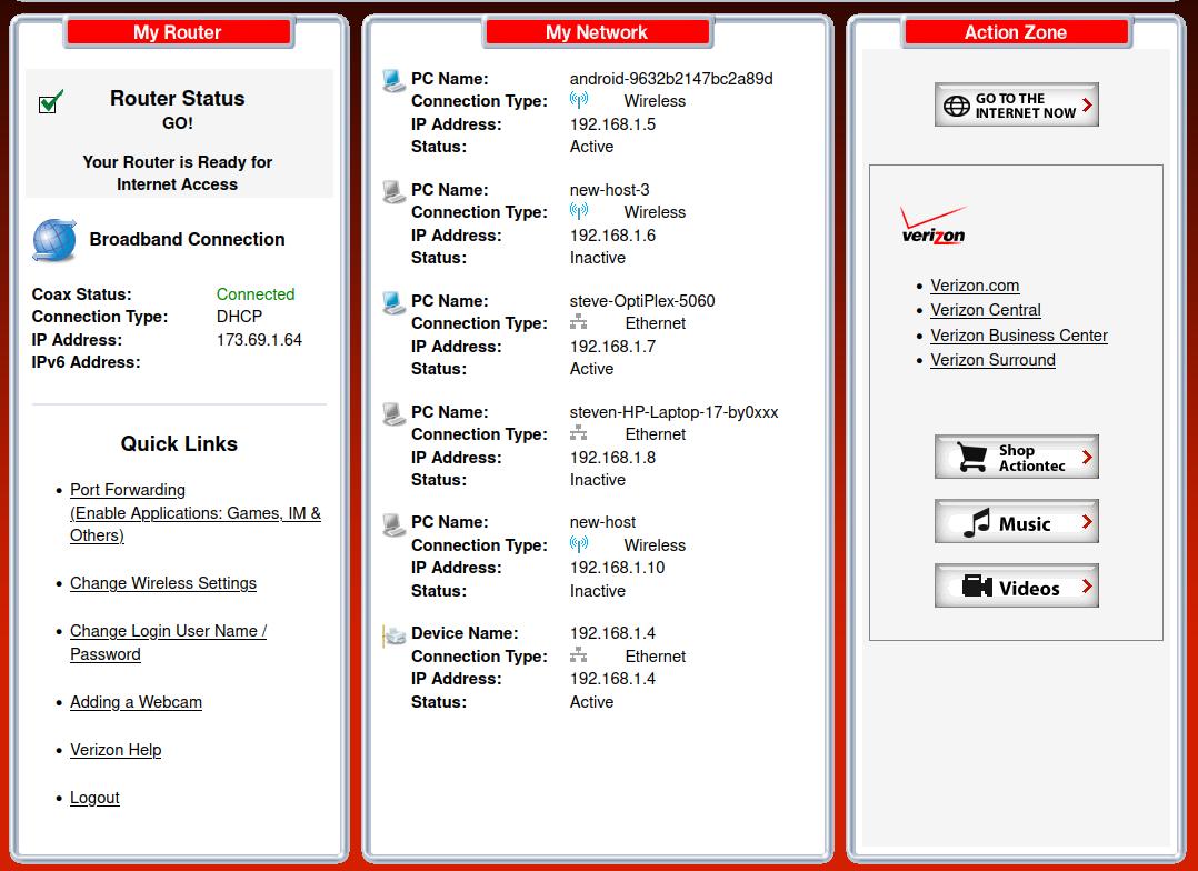

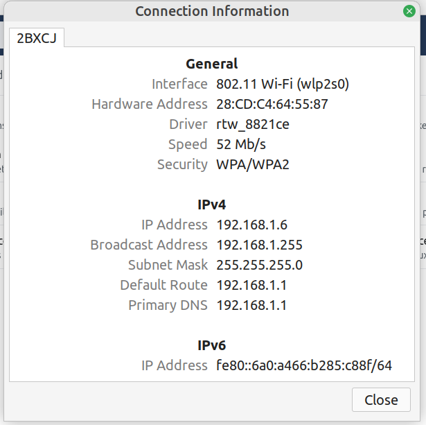

    Update completed, HP Envy 17, sha sums checked, new system functional.  With this update, wifi connection poor to none.  Cable connection good.  No changes to laptop or router.  Rt-click on network icon shows this:
    Laptop-connection-info
    S/shot of router screen showsRouter-home-screen-2023-03-23-
    network elements:
    HP manual shows sequence to edit network connections:
    Router-manual-s-shot
    But I can’t find a means to do any of this, BIOS or otherwise.  It does seem that the SSID and WPA2 are the same, router and laptop, but also looks like the router established a new network element for the laptop with the new OS install.  Any suggestions on this?
      You’ve found out how to view the basic Connection Information and probably noticed that the connection speed fluctuates.

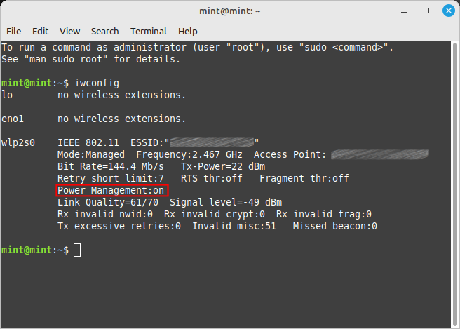

      Power Management:
      1. Click on the Terminal icon in the panel:
      mate_panel_terminal
      2. When the Terminal opens, type iwconfig and press RETURN/ENTER:
      mate_iwconfig
      The results will show you whether power management is enabled:
      mate_iwconfig_results

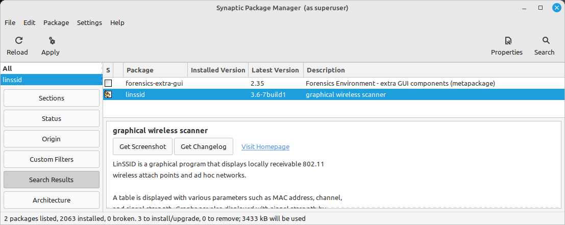

      If you live in an area with lots of nearby WiFi access points then there’s a chance that the channel that’s been automatically chosen may already be congested, especially if your neighbours are using the same ISP/router combo (as the default channel will probably be the same).  You’ll need to use Mate’s Package Manager to install a WiFi channel scanner like LinSSID to see what’s happening around you in order to manually select the least congested channel:
      mate_LinSSID_install

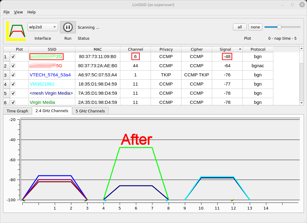

      I’ve just done the same on my own Linux Mint Mate 21.1 laptop:
      LinSSID_before
      My 2.4GHz connection (in green) was on channel 12 (along with several of my neighbours) with a signal strength of -59dBm. This is an OK signal strength that was giving me an average speed of 52Mb/s… but I noticed that mid-range channels (4-8) were not being used by anyone else.
      LinSSID_after
      I changed Wi-Fi channel for the 2.4GHz band from 12 to 6 on my router… and the signal strength shown in LinSSID went from -59dBm to -48dBm, a considerable improvement… and my connection speed increased from 52Mb/s to 144Mb/s. LinSSID now shows my 2.4GHz WiFi connection well away from others on the same channel except for one single distant router that doesn’t affect me.

      An update… mainly because I’ve learned someting and nearly trebled my Wi-Fi connection speed yet again as well!
      My ISP-supplied router is now many years old. (I’ve never bothered asking for it to be upgraded as I have no wish to change package and start a new contract.) Although dual-band, up to now I’ve only used the 5GHz band for my iPhone and iPad which are much newer than my Dell Latitude E7450 laptop.
      As an experiment I decided to disconnect my laptop from my router’s 2.4GHz band, with its now much improved 144 Mb/s connection speed and, instead, connect to its 5GHz band. To my surprise the connection speed shot up to 400 Mb/s with a signal strength of -63dBm!
      LinSSID_5GHz_before

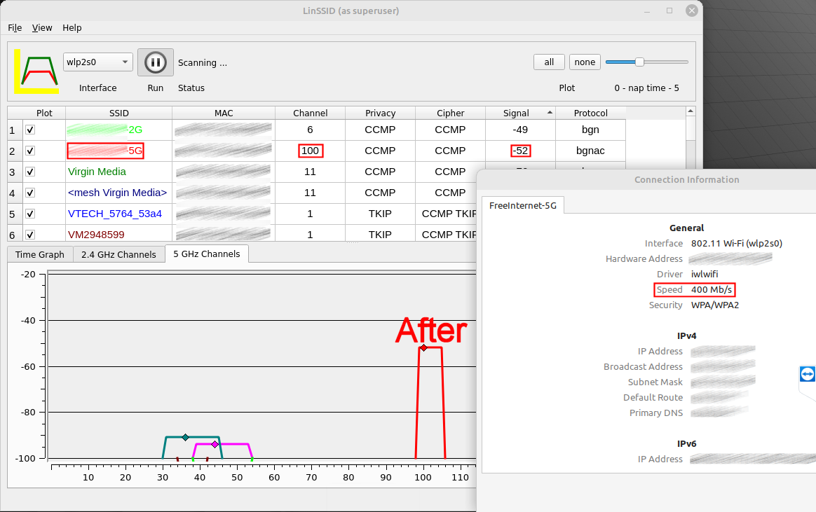

      LinSSID showed I was sharing the channel range with several neighbours so, in the router, I changed the channel range from 44+48 to 100+104… and agreed this warning:
      EU_regs_warning
      After the change LinSSID showed the router was now well clear of my neighbours but, even though the signal strength had improved significantly from -63dBm to -52dBm the connection speed stayed at 400Mb/s… which I suspect is the best I’m ever going to get from the laptop’s ancient Wi-Fi adapter:
      LinSSID_5GHz_after
      Still, a speed increase from 52Mb/s to 400Mb/s for a few minutes tinkering made it all very worthwhile… and I didn’t even disable IPv6! 🙂

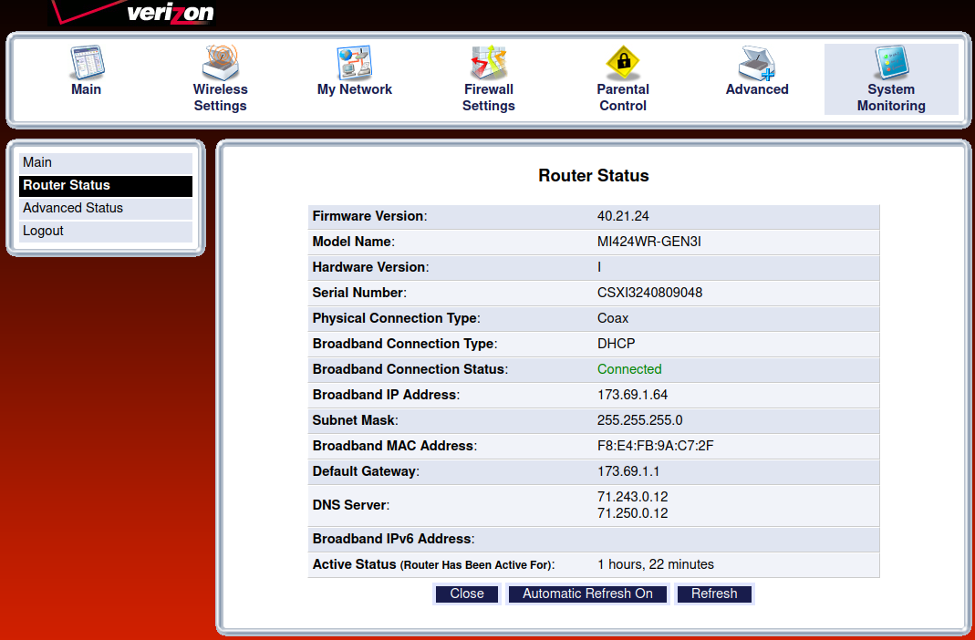

      The puzzle here is that the only change was the updated OS in the laptop.  No elements of the network were changed, no settings altered.  Tested signal strength using smartphone (1st device on list) in various parts of the house, and signal is adequate everywhere.
      There are 3 locations where the laptop is typically used, never had wifi connectivity problems before.  Now the furthest location from the router will not maintain the wifi connection and goes online only via ethernet.
      Also seems odd that the router sees the updated laptop as a new device on the network, for wifi purposes only, for a total of 3 entries to the list (2nd, 4th, and 5th in the column).  FWIW here are additional s/shots from router.
      Network-elements
      Router-status
      Router-wireless-settings

      Your first screenshot shows a MAC address of 28:cd:c4:64:55:87. The first 3 pairs of a MAC address are known as the OUI (Organizationally Unique Identifier) and used to identify the manufacturer/vendor of network adapters.
      Looking that OUI up in a database shows your HP Envy 17‘s wireless adapter is apparently manufactured by Chinese company Chongqing Fugui Electronics Co. Ltd.
      I’m a bit surprised by that… because I cannot find that 28:CD:C4 OUI in the database listing for Hewlett-Packard network adapters and a Google search shows the company is more usually known for its Wi-Fi adapters in Dell laptops… but also:
      IMO even odder is that the 4th and 5th entries have different MAC addresses to the 2nd entry (new-host-3) in the list.
      The OUI for Steven-HP-Laptop-17-by0xxx (MAC address 84:2a:fd:c5:21:85) shows the network adapter is manufactured by HP. This is what I would have expected.
      The OUI for new-host (MAC address 1a:83:c7:8e:69:2b) is unknown, even though I tried a couple of OUI databases, e.g. https://mac.lc/address/1a:83:c7:8e:69:2b.
      Also a little odd is that DHCP services usually offer dynamic IP addresses sequentially, yet there’s no 192.168.1.9 showing in the router screenshot.
      I suggest the next step is to turn your HP Envy 17 laptop off then check the router list again from steve-OptiPlex-5060 to see whether all 3 other entries disappear… ‘cos I can’t think of a logical explanation except they are different devices.
      Alternatively, turn off everything wireless you can except for a smart phone. Use it to run Fing to double-check what the router is seeing.
    • #2546675
      With the laptop shut down, the router home screen (red border, 1st post) now shows 5 devices- the phone and the desktop “active” and 3 listings for the laptop “inactive.”  The printer (.4, last listing on s/shot) is now not shown.  Odd, because in that s/shot, the printer is listed and marked “active” but it was shut off when the s/shot was taken.
    • #2546783
      The oddities with the router are still unsolved, but the primary issue- wifi connectivity to the laptop- was corrected with help from the Mint forum.  Turns out SecureBoot was enabled in the BIOS- once disabled, wifi was available.
      Don’t know whether the apparently extra network entry in the router needs to be addressed or not.  Perhaps someone can say whether that is a sleeping dog or needs attention.  Big thanks to Rick Corbett and everyone else who worked on this on my behalf!
