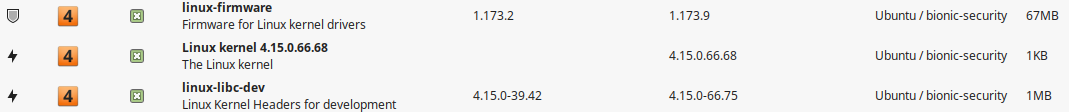

I’ve been seeing Kernel updates in my update manager and am a bit reluctant to mess with them. There are three of them and the main one is marked security and is 67 MB. Is this something I should be concerned about? My Linux Mint laptop is running just fine and I don’t want to mess anything up. All these updates have a rating of 4.

DrBonzo
AskWoody PlusNovember 3, 2019 at 7:24 pm #1998609@Charlie – For whatever this is worth – I’ve been running Ubuntu 16.04 LTS for the last 27 months on an old HP AMD Athlon 64 bit machine (about 10 years old). As an experiment to see just how much of a no-brainer patching is, I install every update offered to me – yes, every single one of them. I’ve installed many kernel updates and also many updates that remove unused portions of old kernels. I’ve never had any problems with any updates (kernel or not). A conservative estimate is 5 patches a week, so over 27 months 600+ patches. If it was me, I’d go for it on your Mint machine.
JohnW
AskWoody LoungerNovember 3, 2019 at 7:29 pm #1998610My understanding is that if the kernel update offers no security updates, but just additional compatibility for newer hardware, then you are safe to skip it if your hardware is running fine, or you are running an older system.
But I would install all updates that are flagged for security.

AskWoody LoungerNovember 4, 2019 at 12:34 am #1998728Right.
My understanding is that if the kernel update offers no security updates, …
But I would install all updates that are flagged for security.Now I don’t know how Mint’s update manager does it, but in the general case with Linux kernel updates this means installing those that only change the third or fourth part of the version string.
(Third number is the “minor release” and fourth is patches on top of that. Ubuntu backports fixes a lot, they’re well into 4 digits on the patch number in some branches and a bit less in others. So Ubuntu has a version 4.4.0-166 instead of going to 4.4.198…)
Also I’m not sure if others are doing that but I’m of the opinion that anything that has the potential to cause significant data loss or corruption even independent of external threats should be considered a security issue.
So, I’d install patches that’d fix data loss if your specific SATA HBA chip happens to have a hiccup. But that’s often dependent on hardware and requires a close reading of the changelogs…

AskWoody PlusNovember 4, 2019 at 9:13 am #1999051Thank you JohnW, these Levels are what have held me back. I called them ratings by mistake. The kernel updates in question are all level 4 which are considered unsafe. There are a few other updates that apply to the kernel and are Level 2 “software” updates. I wouldn’t have any qualms about installing these if I knew something about the kernel and if they were all Level 2’s.
I trust Levels 1, and 2, maybe even 3’s, but the 4’s worry me. I don’t know how to revert back to the older kernel. Seems I have a lot to learn. I want to do the right thing but then things are running well so I don’t want “fix what isn’t broken” to coin a phrase.
One other thing I’m wondering is whether or not if I checked all the kernel related updates, the Update Manager would know the proper order in which to install them?

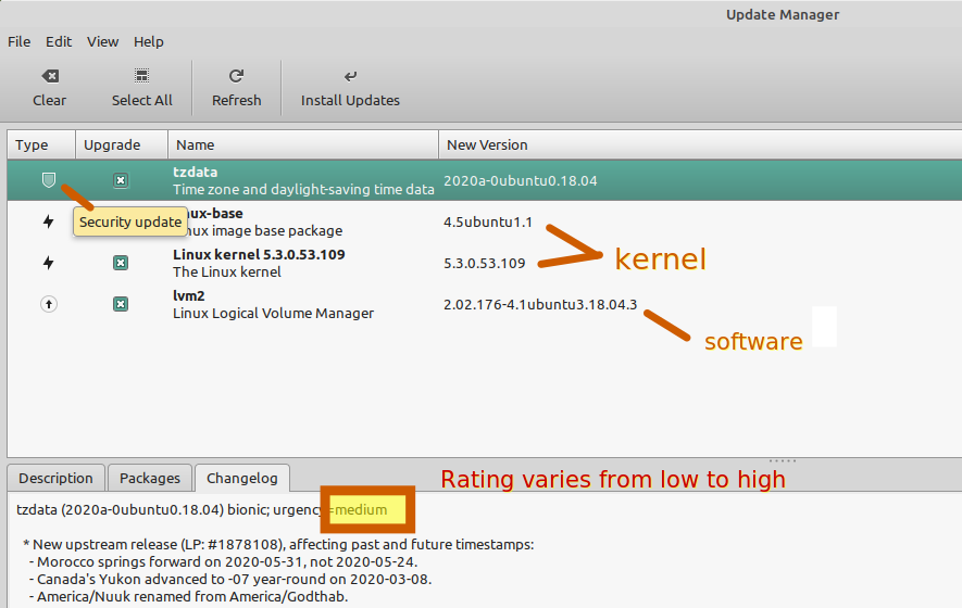

Ascaris
AskWoody MVPNovember 5, 2019 at 11:20 am #1999695That said, I’m a newbie in Linux but haven’t had any problems so far just taking all the updates in 19.2, including kernel updates (in the 4.15 series). Of course, this isn’t my primary computer, and it wouldn’t be too difficult just to reinstall Mint.
With a kernel update, if the new one fails to work, simply reboot, select the “advanced options for Linux Mint” option in the GRUB menu, then scroll down to the listing for the previous kernel version. The first option will be the newly installed one that isn’t working… the second one will be the recovery mode for the new kernel. Right below that should be the previous kernel, the one that was working fine. Hit enter, and everything should be just like it was before. You can then search for answers online, or just uninstall the version that does not work.
Within one kernel version, like 4.15, the kernel updates will mostly be for bug fixes and other enhancements. There is a chance of new bugs with any updated software, but it’s greater for releases that introduce new features as well as bug fixes. I wouldn’t have any reservations installing them… I’ve never had any issues doing so personally, and the means to boot the old kernel (which is still installed in addition to the new one, unlike most packages) is so easy, that I don’t consider it a big risk.
I regularly go one step further and update to the newest kernels offered by Ubuntu. In Mint, you can easily do that by looking in the Kernel menu of the updater program, which will show you all the Ubuntu kernels available. Mint uses the Ubuntu kernels, like other Ubuntu derivative distros (which also includes KDE Neon, which I use). The current newest version offered is 5.3, which is eight releases newer than the 4.15 kernel that Ubuntu 18.04 LTS and derivative distro releases (like Mint 19.x). If it fails to work properly (or at all), the same method above to boot the previous version will work.

AskWoody PlusNovember 5, 2019 at 12:58 pm #1999801Just for information purposes here are the three Level 4 kernel updates:
Notice they are checked and come up that way. There are other level 2 updates relating to the kernel and labeled Software which I have not done so far. I need to build up more confidence before proceeding. It’s me, I’m always over cautious.

AskWoody LoungerMay 21, 2020 at 1:32 am #2264521I like how Mint handles updates. I install the security updates almost as soon as they show up and tend to hide the kernel updates until I am ready for them.
The software updates can be odd and I used to hide the ones I was unfamiliar with (old Windows habit of fearing “feature” updates that break things). For example when I moved to Mint I installed the multimedia codecs which included flash and chromium. I disable flash in Firefox and don’t use the Chromium browser so when a flash non-security update arrived I just hid it. About a week later I checked my plugins and Firefox complained that flash was out of date and insecure. I re-found the update and installed it and things were fine.
Recently I received several chromium updates and decided to uninstall the codecs since I don’t use them but I would have to uninstall the multimedia codecs package they are part of as well. Updating the chromium seemed easier than finding and reinstalling all the other codecs, 🙂
My update routine is:
- clean with Bleachbit
- scan with Clamtk
- run Timeshift
- install updates.
This works well for me.
Attached is a screen of Mint’s Update Manager for those unfamiliar with the OS.
