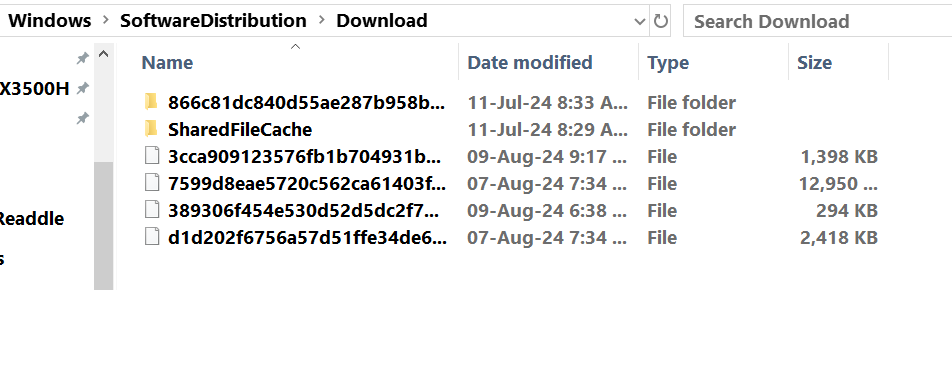

    • #2627153
      Can you then locate and Delete the unintended Download?
      Go to C:\Windows\SoftwareDistribution\download and delete all files.
      Run wushowhide.diagcab / WUmgr and hide KB5034441

    • #2694742
      How can i delete the KB5040525 from my Windows download
      Delete all files in ‘softwaredistribution’ folder or rename the folder to softwaredistributionold

            • #2695073
              The way to remove it from the Windows Update queue requires the use of an Elevated Command Prompt.
              In the Taskbar search bar type cmd and hit Enter.
              In the results, at the top, right-click on  cmd.exe and choose “Run as Administrator.”
              In the Command Prompt that opens, copy/paste each of the following lines one at a time followed by Enter after each one:
              net stop wuauserv
              net stop cryptSvc
              net stop bits
              net stop msiserver
              Ren C:\Windows\SoftwareDistribution SoftwareDistribution.old
              net start wuauserv
              net start cryptSvc
              net start bits
              net start msiserver
              Type Exit and press Enter
              Restart your computer.
