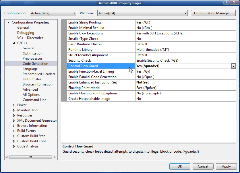

Noel Carboni
AskWoody_MVPNovember 25, 2017 at 9:27 pm #147392Uhley said Control Flow Guard, a memory corruption security technology baked into Windows 10…
For what it’s worth, authors can build Control Flow Guard into applications destined to be run on older operating systems too, as long as they’re building their Win32 applications with the latest Visual Studio and SDK…
I need to do some measurements to see how it affects performance.
