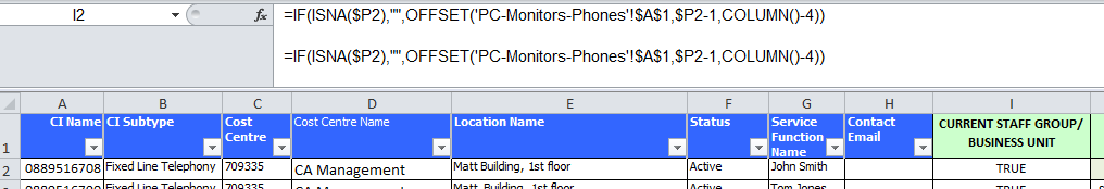

      I have worked in your code and the example is attached. The only thing I dont understand is Column I on Extract (Ture or False). And a further thought is, how can a duplicate be identified?
    • #1453639
      If you expand the formula bar, you can see the problem in I2:
      37076-I2-Formula
      This is the same for all the formulas in Col I. For whatever reason, you pasted it into the cell twice and have essentially:
      =Formula=Formula
      Which since it is the same formula you are comparing it to, will give TRUE. You can edit I2, to just have the 1 formula and then copy it down the column or just copy the formulas from col J to col I to fix it.
      Steve
      PS, what do you mean by duplicate? and identifying it in what sense? When I used the term, I used it in the sense that a lookup would only be in 1 of the columns from A to E, it would not be in more than 1. If it appears in more than 1 then “found row” would be wrong since the “found column” would be wrong….
