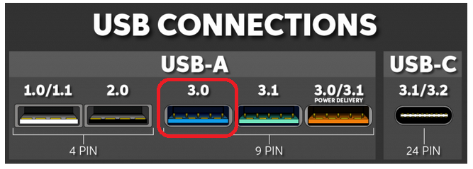

      When I checked my device manager I found several root hubs, one of which is (USB 3). I also found an Intel (R) USB 3 eXtendible Host Controller- 1.0 (Microsoft).
      I found TP-Link TL-WN823N N300 Mini USB Wireless WiFi network Adapter on Amazon.  IF that is the one you have, it has a USB-A connector.  Your Device Manager says your motherboard supports USB 3.
      That means that at least one of the ports on your PC looks like the one highlighted in red:
      USB-Ports-1
      That’s the port where you plug in the adapter if it has a USB-A connector.  If it has a USB-C connector, there is an adapter for that, too.  They are shown in responses to your previous thread.

        I  finally found  two (blue) USB 3 ports  after pulling out everything that was plugged into the many ports in the rear of my computer. I plugged the mini-wireless USB adapter that I recently purchased and it’s working properly to boost my wi-fi signal.
        Thanks to all of you your patience and your guidance. I would be lost without your help.
