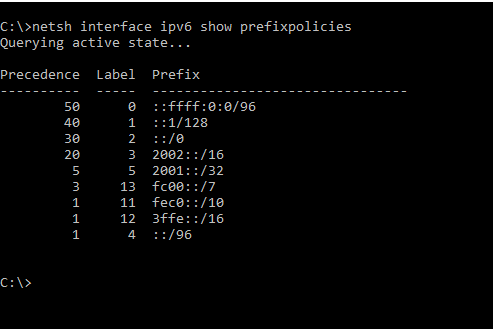

    For those more technically minded, the priority of various IP protocols can be verified and configured by typing in a command line (without getting into details):
    IPv6PrefixPolicies

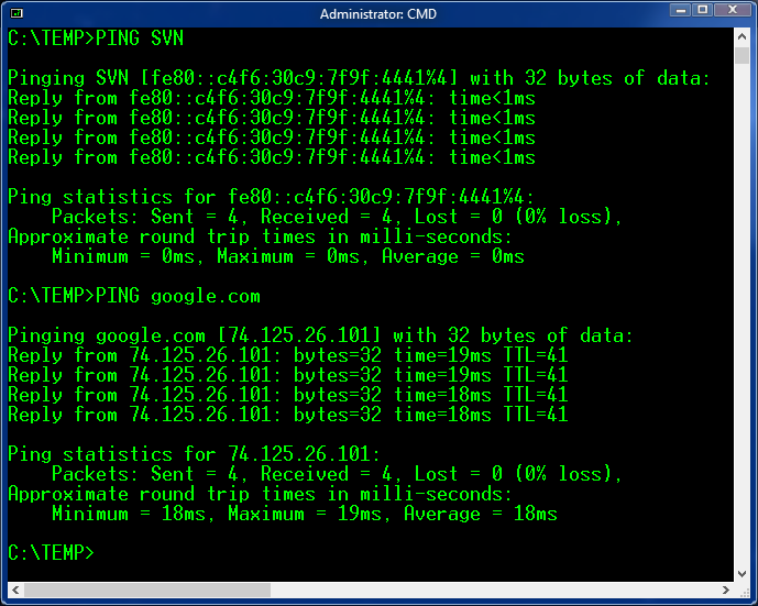

      Personally I don’t have any “native” IPv6 capability enabled through my ISP yet I still prefer to simply disable the tunneling interfaces (isatap, 6to4, teredo) entirely with netsh commands. I consider tunnels as presenting a security risk and potential privacy issue.
      This of course won’t keep if/as servers worldwide start using IPv6 exclusively. I have this fantasy that my ISP will start offering “native” IPv6 capability before that becomes a problem.
      My systems on the LAN primarily intercommunicate with one another via IPv6, proving the point that IPv6 is by default at higher priority. I need to think through whether reordering the protocol priorities on my LAN could be useful at all. All my LAN systems have both IPv4 and IPv6, so it may just be a moot point. I’ve never done any detailed testing to see whether IPv6 communications are any more or less efficient than IPv4 communications. I suspect the differences aren’t large.
      By the way, a way to check to see if you’re communicating via IPv4 or IPv6 with another computer in particular is to run a PING command. Two examples shown here:
      ScreenGrab_W81EVM_2017_02_28_213341
      The above shows, by the form of the addresses, that SVN is being reached by IPv6, and google.com is being reached by IPv4.

              They don’t set the DisabledComponents setting. I was just looking at my workstation’s config earlier today.
              As I’d prefer IPv6 in house to be the preferred protocol to ensure my local SVN accesses are fastest, I’ve gone ahead and set it to 1 and will see whether I can notice any difference in usage over just having disabled the interfaces via netsh. So far I have sensed nothing different.

              I read something online about each bits of the disabledcomponents value having a specific meaning for each protocol so it would make sense that using netsh modifies the value, unless the value itself overrides anything netsh can do.
              I know that using it at ff and then doing the netsh int ipv6 6to4 show state showed disabled after using ff while it was enabled before.
