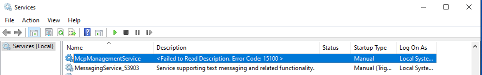

        For example McpManagerService outputs error 1500. It took me ages to find out why. In the end it turned out that neither administraor, nor the System accounts have the right to access mui files.
        Some services should run under the local account but if they can’t then they run under user process ID which are those number that are attached to the name of the service.
        In these cases they get started under the inbuilt administrators account (which is cheat anyway) but because in this case the Administrator doesn’t have enough rights even that doesn’t work.

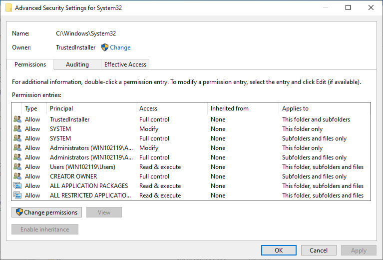

        • #2698200
          It is NORMAL for the Windows folder and the System32 folder to have security descriptors specifying the Owner as TrustedInstaller and not giving the Administrators group or SYSTEM the right to change permissions.
          For C:\Windows
          WindowsSec
          Permissions for the Administrators group (this folder)
          WindowsAdmins
          For C:\Windows\System32
          System32Sec
          System32Admins
          Regardless of the presence of inheritable permissions in a folder’s security descriptor in many cases there are sub-folders and files beneath the Windows folder that only contain explicit permissions and no inherited permissions from their parents.  Attempting to reset the security descriptors of Windows and its sub-folders manually is unlikely to produce results identical to those of a successful installation of windows.
          The 15100 error related to descriptive information for the McpManagementService is strictly related to a missing MUI dll from which those text strings should be obtained.
          Mcp1
          This is a cosmetic problem.

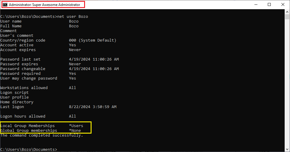

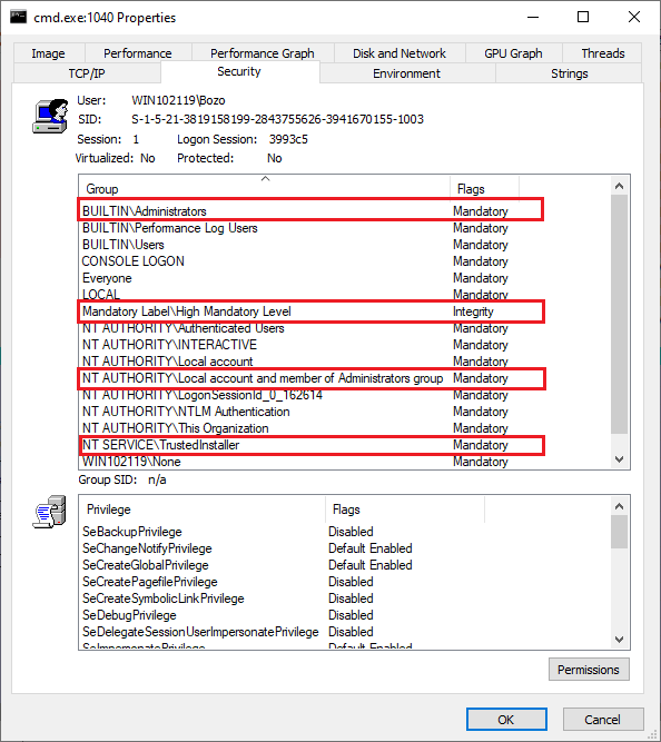

          As an example, following shows result of turning a standard user into “Super Awesome Administrator” for a single process running cmd. The highly privileged token is displayed using Process Explorer.  Note that the account information for the user was not changed by this one process token transformation. This was done with my own code, not the Nirsoft utility.
          Console window –
          BozoReal
          Process token
          BozoAwesome

              As I said in my post, I created “Super Awesome Administrator” with my own code.  I did not use AdvancedRun by NirSoft.

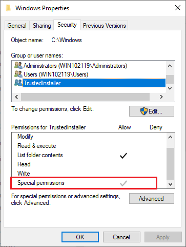

            That is another thing: here is a screen shot of TrustelInstallers permission. It only has listing access.
            Isn’t that strange. It is the same thing. In the advanced table is has full access but I can’t see what are its effective access because it is not an of the object by that name.
            This the same with System32. And yet on the file you can get Everyone to have full access on the file.
            This is what I mean. There is something odd going on.
      There was no screenshot visible in your post.
      There are many individual permissions associated with file and folder access.  The Security tab user interface and the Advanced display present summaries.  For example, Read and Execute is not a single permission but represents a specific combination.  When the rights don’t meet the predetermined combinations for display the “Special Permissions” category is checked.  If you had scrolled the display for the Windows and the System32 folders you probably would have seen this with respect to TrustedInstallers. I don’t know why Windows does this instead of showing Full Control in the Security tab display.  It does the same thing for Administrators and SYSTEM.  I’ll speculate that this is related to the way that inheritance for these accounts is specified in the DACL.
      Windows folder
      TIWindows
      System32 folder
      TISystem32
      I have several services like McpManagerSrivce return errors in this case 1500 associated with access to files not being adequate.
      System error code 1500 means “The Event log file is corrupted”. If you really mean code 15100 as displayed by services.msc then this is a cosmetic error due to a missing file.  It is not an access denied problem.  I have seen it many times and it does not interfere with starting the McpManagementService.

        I know about the Special permission. I use the Advanced and then the Effective Access tab where you can interrogate individual access rights for any object that can have rights. This is the issue; just because something has rights in the explorer properties it doesn’t mean that it is not affected by the amalgamation of rights. Indeed in the Advanced section Administrators have full access to the folder and then repeated for the files and nested files of the children’s folders but those are not the effective rights.
        You can’t inspect TrustedInstaller though because it is not part of object categories in NT. So, I couldn’t see the effective rights. I think this is why when I used Nirsoft tool to run as TrustedInstaller, it didn’t work. So, the tick on special permission was not saying anything to me at that stage.
        This time I RanAs NT Authority and managed to change access. So, I managed to sort out all the problems except for the 15100 in services for McpManagerService are now gone from Event Log.
